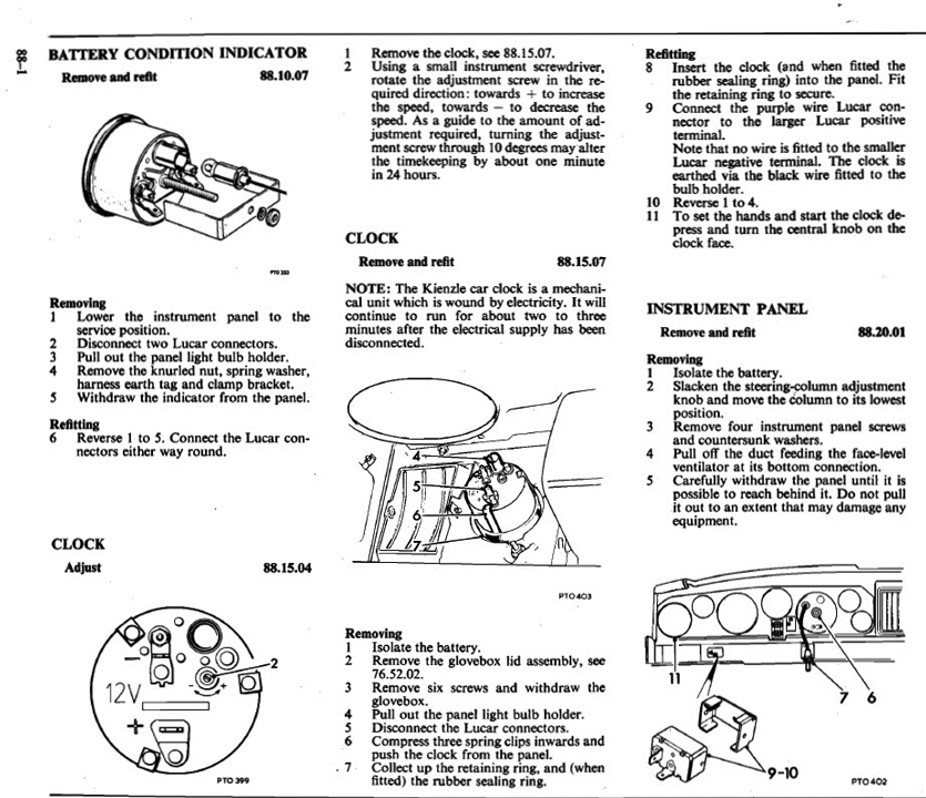

I need to replace the bulb in the clock and assume the best, and maybe only way to get at the clock is to remove the glove box. I did read somewhere on the Forum about access through the speaker grille/ speaker, but I'm not sure about this.
So, what is the sequence for removing the glove box and where are the necessary screws?
Thanks for any help.

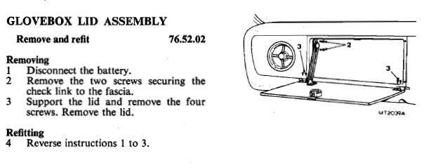

Lid Srew location and clock removal and refit from the repair manual:

After removing the glovebox lid, you'll need to remove the slightly recessed screws which secure the glovebox former to the dash chassis, including the two that secure the lock keep, and then draw the former out of the recess.
