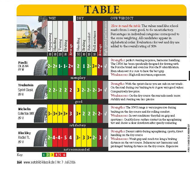

13" tyres are becoming more and more obsolete.
on top of that the carcass design of modern tyres is becoming less and less suited to the chassis geometry of cars like Dolomites. Even within the specialist tyres, there are difficulties with the Avon closing their factory, among othere things this was where the Dunlop were made.
however these is good news from Michelin and Pirelli. this page shows a good selection of 13" tyres
https://www.longstonetyres.co.uk/vintag ... es/13.html
Pirelli have also recently added a 155R13 Cinturato CA67. this is a H rated sports car tyre and is absolutely perfect for loads of Dolomites.
https://www.longstonetyres.co.uk/classi ... omite.html
the Cinturato range is remarkable in that not only is it currently the best performing classic car tyre out there the prices, particularly of these 13" tyres is remarkably good.
Have a look at these tyre tests, it shows how much better they are than the predominently totally modern tyres they are being tested against.
https://www.longstone.com/classic-tire-test
The Michelin, Dunlop SP Sport and Pirelli Cinturato are the only proper classic car tyres in these tests, the rest are modern tyres that should have benefitted from modern computer modeling and have all sorts of benefits, (they do do better on noise and rolling resistence) however the Pirelli repeatedly knock everything else into a cocked hat. because they use modern compounds and modern build quality, but on a carcass perfectly suited to your car.
