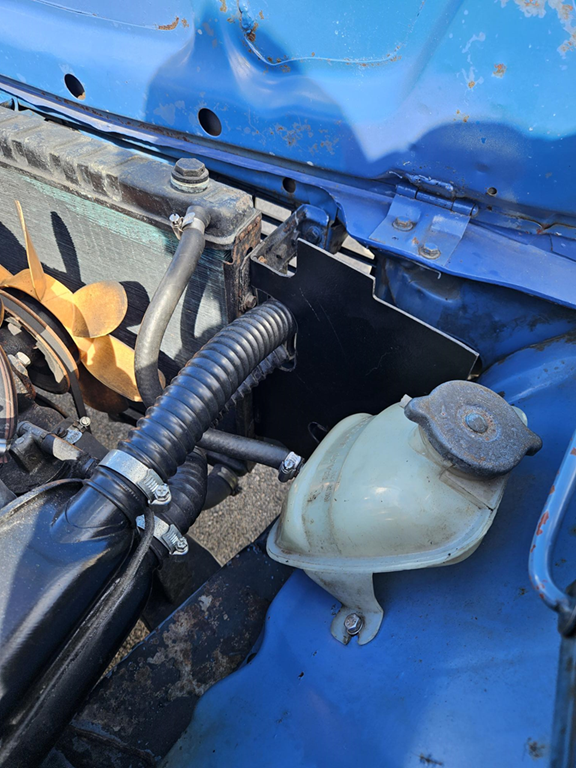

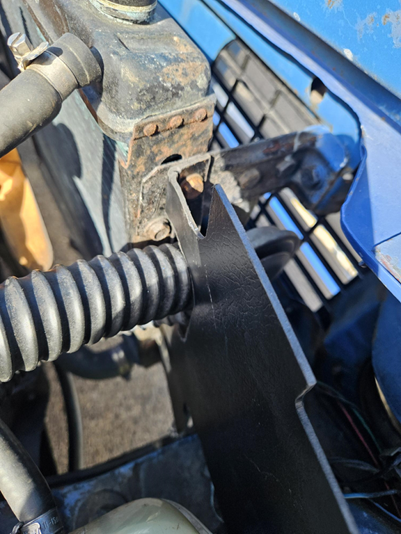

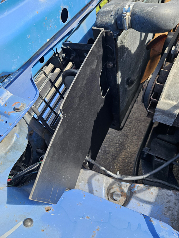

As per the title I bought the Toledo/1500 Cardboard Radiator Cowl set to trial fit to my 1975 1500TC.
This is not a complaint at the parts, just an example of the fit to my modified car with the battery in the boot.
My thoughts are for my car the battery side fits very well, and I will make a steel bracket to attach it to the wing since the battery is not there to support it.
On the Air box side, it’s in the way of the air box tubes so I will remove it and hopefully replace it with the “All Air filter pipe brackets and fibre boards” I bought from the club once the paint dry’s and I will add more photos.

- Cowl - Battery side.png (827.12 KiB) Viewed 798 times
- Cowl - Battery side 3.png (848.1 KiB) Viewed 798 times
- Cowl - Battery side 2.png (849.24 KiB) Viewed 798 times
- Cowl - airbox side.png (844.11 KiB) Viewed 798 times
- Cowl - airbox side 2.png (780.75 KiB) Viewed 798 times

Today I fitted "All Air filter pipe brackets and fibre board" from the club with some new 1-1/2in corrugated hoses and I am very happy with the out come. I will probably replace the fibre board with steel if it starts to fail (already copied it on to a bit of sheet steel so maybe cut it out and paint it in blue for the future.
I think it fits very well on my car, although I did have to slot out the mounting holes just a bit, but we all know no Dolomite is built the same!
Regards
Barry
