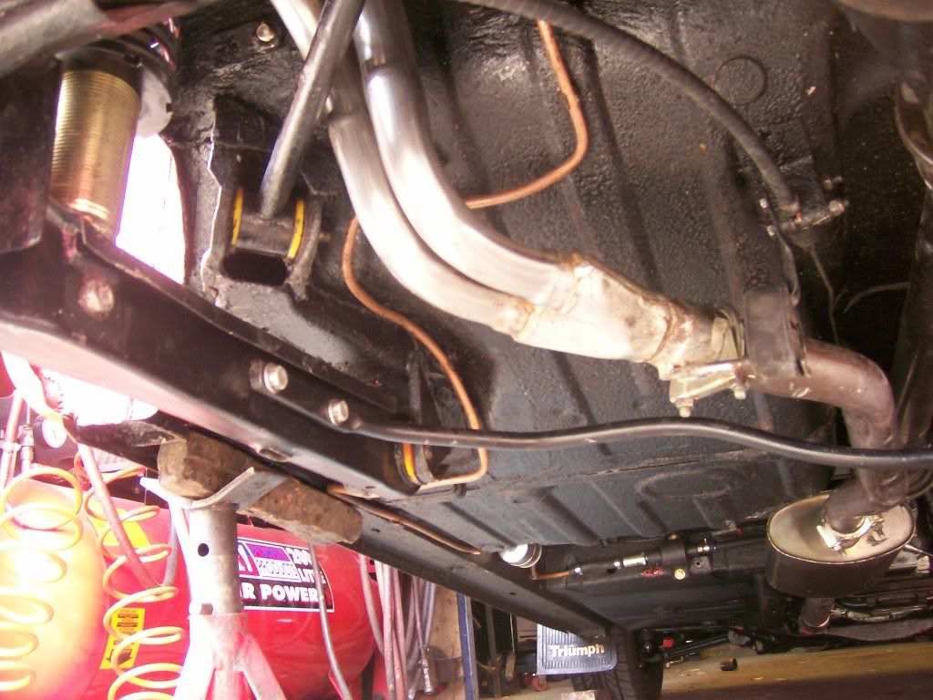

by sprint95m » Fri Oct 19, 2007 1:09 pm
Your car looks very good. Especially with early instruments.
A couple of questions, does speedo need recalibration and can you use a Sprint speedo cable?

by Dollyboy » Fri Oct 19, 2007 5:29 pm
lookin good mr custard
how the fook did you manage to get the top arm bushes to fit? (assuming they're the rimmers ones?)
i used shock bottom bushes as recommended by a chap at rimmers, worked a treat

by triple tango » Fri Oct 19, 2007 5:46 pm
speedo uses either early Stag o/d cable. Bushes were a fiddle untill I cut the spacer in half & pushed from both sides at same time.
