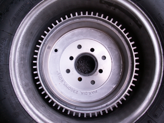

Has anyone tried modifying alloy Dato 240z brakes to fit a sprint?
I know it's been done on the larger saloons, also found an article here:
http://www.triumphowners.com/resources. ... nID=111025
Thinking about doing it if it works out comparably with buying (and shipping) new Sprint drums.
SPRINTPARTS
Re: Datsun 240z brakes
#2 Post by SPRINTPARTS »
Garth, I like the idea.
I have a good contact with brake supplies, so I will find out if they are available locally (Australia) and what sort of price they are talking. I will see if i can get my hands on a drum to see how much machining is required to make them fit the rear of a Sprint.

would finned drums fit under sprint wheels? the standard ones are already quite close to the wheel.

The finned drums maybe a problem under standard Sprint wheel, but I don't have standard wheels, (13" BBS), and I can't drill anymore holes in the brake drums or backing plates or they will fall apart, and I have ducting feeding there as well. The alloy drums should be considerabley lighter than the standard cast iron.

Hey Mark, glad you like the idea! I think it should be an easy mod as the Sprint PCD is smaller than the datsun, so just a case of re-drilling further in.
I think the finned bits won't be a problem as they are on the inside (back) edge of the drum as the wheel "spokes" slope backwards.

I now have a pair of new 240z finned brake drums. As we thought, they WILL NOT fit inside a stardard Sprint alloy wheel, but will fit inside my BBS wheels.
Will now get them drilled to match Dolomite PCD and enlarge centre hole. When done will post a photo for all to see.

So ... an enterprising individual might put the drums in a lathe and remove the fins to make them fit under standard wheels...? :idea:

Below is a photo of alloy drum inside my 13" BBS wheels. It only just fits, and to make them fit inside a Sprint alloy I would imagine that most of, if not all of the fins will need to be removed. I think that I can get some second hand drums if interested, but a fair bit of machining will be required.

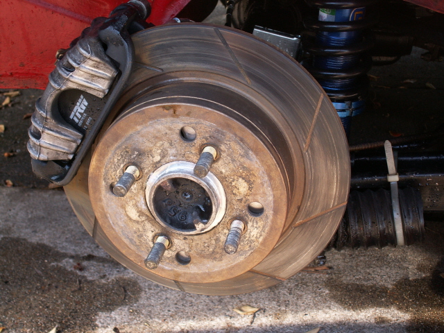

I have not used the alloy drums as my car now runs a disc brake rear end, but it is also not a Triumph axle assembly. I am tired of trying to use 30+ year old parts so have gone for something a bit newer, and hopefully it will be indestructible.
Disc brake rear.JPG (259.12 KiB) Viewed 3599 times
PS. I should add that these discs are 250mm, almost the same size as the fronts. I used this setup for the first time last weekend, seems to work OK, just learning to get the best from them at present.

Looks good! Race regs allow non-original axle then? What axle are you using?

The basic diff is a Borg Warner assembly, locally (Australian) made in in numerous Aussie built cars. This particular housing is from a Nissan Skyline R31/Nissan Pintara.
It has had all original brackets removed and Dolomite brackets welded on so that it bolts up to standard mount points. It uses a 4.1 LSD (numerous ratios available from 3.08 to 4.1), and using standard Nissan disc/caliper setup. It is 100mm wider than a Sprint, so now flares are fitted to the 'guards and the front track has been widened.
The only downside so far is that it would weigh at 10-15kg more than the Sprint unit. The axles are about twice the diameter of a Sprint axle, so hopefully no axle flex or oil leak problems ever again.
