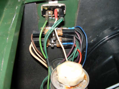

Yes it does!<br>
<br>
<!--EZCODE IMAGE START--><img src="http://www.dolomitesprint.com/images/fuse.jpg" style="border:0;"/><!--EZCODE IMAGE END-->

#25 Post by Leeds Sprint » Fri Jul 21, 2006 10:11 am
Some of you have mentioned how electrical issues can affect cooling. <br>
<br>
My Voltage gauge is reading 14.5 volts. Is that too high? Would that contribute to overheating at all?<br>
<br>
Thanks<br>
<br>
Chris
<p></p><i></i>
Posts: 1311
Joined: Sat Mar 08, 2003 8:28 pm
No....
#26 Post by Jon Tilson » Fri Jul 21, 2006 10:43 am
You need the voltage coming from the light green wire feed to the instruments, which comes from the voltage stabilsier as shown in Marts photo. Even though your volt guage reads 14.5, a normal reading form your alternator, thats no guarantee the stabilser is working as it should. If you turn all your lights, wipers and hrw and heater fan on you will see the volt meter reading drop...<br>
hence the need for the stab so yor instruments read as they should.<br>

#30 Post by Leeds Sprint » Sat Aug 05, 2006 2:52 pm
Mart<br>
<br>
In you picture of the stabiliser there is a white cable with a read connector. My car does not have this cable. Where does it go to? And should I have one too?<br>
<br>
Thanks again<br>
<br>
Chris
