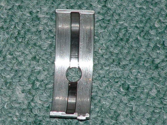

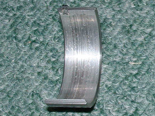

Anyway, I took some piccies of one of the mains & one of the big end bearings. There is slight scoring & pitting to them. Do I fit a new set of each whilst I'm there ?<br>

<!--EZCODE IMAGE START--><img src="http://www.dolomitesprint.com/images/bearings3.jpg" style="border:0;"/><!--EZCODE IMAGE END--><br>

<!--EZCODE IMAGE START--><img src="http://www.dolomitesprint.com/images/bearings4.jpg" style="border:0;"/><!--EZCODE IMAGE END--><br>

While yer in there....
You now the answer to this....its daft not to do them all<br>
as they are so cheap and what is it gonna cost you if one picks up? Shells are sacrificial...<br>
Moss do them....one in Bristol....cos they are the same as TR7 ones.<br>

I've got 16 in this size at the moment. No good to you I'm afraid. Definitely change them and well done for catching it before bottem end destructothon!<br>

It's silly not to do them while everything's off, and those do look a little pitted and have slight wear marks - I might push my luck on a car I'd use once a week for shopping, but anything else I'd replace them before seeing the road again.

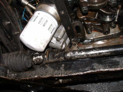

seems to be a bit close to the steering rack. ie. nigh on touching. Engine mounts are on the correct way although sagging slightly.<br>
<br>
Any ideas ?<br>
<br>
<!--EZCODE IMAGE START--><img src="http://www.dolomitesprint.com/images/misc/misc1.jpg" style="border:0;"/><!--EZCODE IMAGE END--><br>
Oil pump nearly touching steering rack.<br>

Any ideas as to why my pump is so close ?

My monies on ya Gearbox mount has gone south. On XAA the Oil pump was a Natts Knacker away for the rack. the Gearbox mount was a soggy oily mess. New gearbox mount really increased the clearance <!--EZCODE EMOTICON START ;) --><img src=http://www.ezboard.com/intl/aenglish/im ... s/wink.gif ALT=";)"><!--EZCODE EMOTICON END-->

Cheers Malc, I'm pretty sure the g/box mount is ok, but it's got to be that or the engine mounts hasn't it ?
