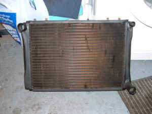

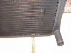

Rads
The viscous fan on my track Sprint decided to release itself from the pulley wheel on Friday with predictable results. The rad on the right is obviously a Sprint rad but what is the rad on the left. I had this as a spare in my garage loft & when I went to get it down today noticed the difference in the core design.<br>
<br>
<!--EZCODE IMAGE START--><img src="http://www.dolomitesprint.com/images/rad1.jpg" style="border:0;"/><!--EZCODE IMAGE END--><br>
<br>
<br>
<!--EZCODE IMAGE START--><img src="http://www.dolomitesprint.com/images/rad2.jpg" style="border:0;"/><!--EZCODE IMAGE END-->

CORE blimey FANcy that
Spectacular, guess you had a few revs on when it let go <!--EZCODE EMOTICON START :x --><img src=http://www.ezboard.com/intl/aenglish/im ... s/sick.gif ALT=":x"><!--EZCODE EMOTICON END--> . Hard to be precise going by only photo's, but looks like your spare rad is an 1850. These are physically the same size, but have fewer gills per inch. If it is a 3row core then chances are it is a Sprint rad that has been recored at some time with a 'less dense' core.<br>
<br>
PS I didn't bid on that viscous coupling, looks as though you need it more than me <!--EZCODE EMOTICON START ;) --><img src=http://www.ezboard.com/intl/aenglish/im ... s/wink.gif ALT=";)"><!--EZCODE EMOTICON END-->
