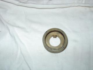

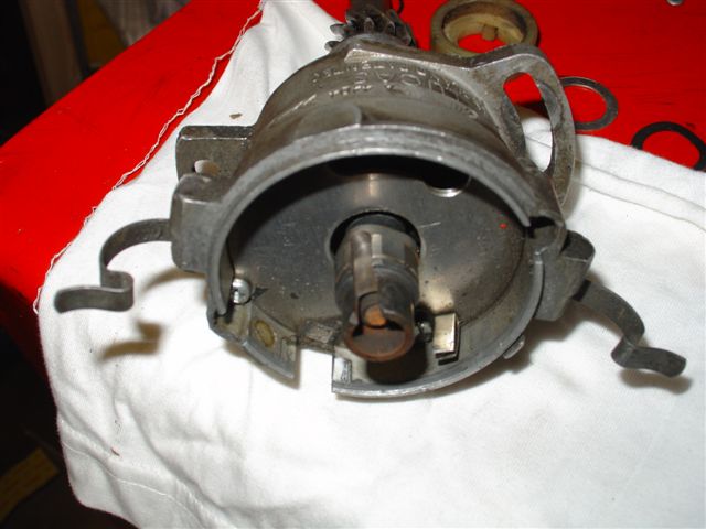

just found this thread, im also thinking of fitting the magnetronic, does the plastic ring which fits over the dist shaft have a specific cut away in order for it not to move as my shaft has no cam profiles.

hi there, how does the plastic ring with the magnets fit over the shaft, does it have a plastick tongue to fit in the shaft groove, like a woodruf key.
or does it rely on your dizzy having the points style cams to secure it?.
distributer shaft.jpg (46.64 KiB) Viewed 7151 times
magnet ring.JPG (8.67 KiB) Viewed 7141 times
