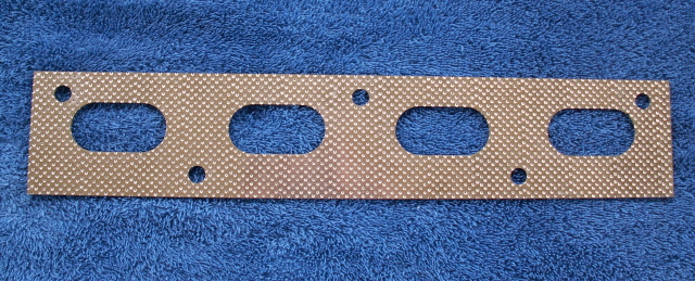

also it came with a "one piece" exhaust gasket, rimmers say they never did one, any suggestions.
We can supply a one piece exhaust gasket. Price is A$35 plus post.
