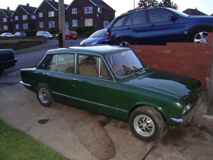

just bought a 3/4 finished dolly 1850 manual paid £350
had a engine rebuid with £500 worth of paperwork so its fresh still not in the car not even done a mile yet
bodys not too babes had quite abit of the welding done to it 2 patches left (hopefully)
have a problem with the dizzy its not in the engine yet was wondering how 2 fit it properly as it will need timeing i think
other than that its a nice old car n im enjoyin playing with it
any advise is welcome as im new to triumphs i normally have opels

yea thats helped alot everything is ready on the engine now its goin in 2moz weather permitting
theres loads a things that are new 2 me on this car its all pretty much the same as my kadett just odd things that are diff n im not sure what to do with e.g the tie bar rubbers where do i get them from ive typed it in on ebay but nothing any help with them /
