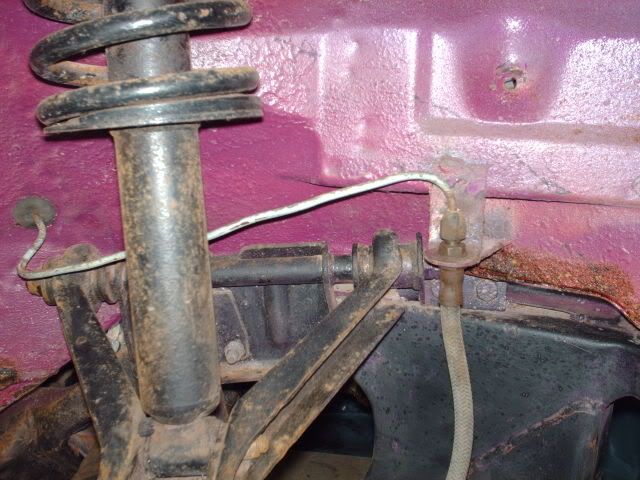

Beware that rust mark running along the outside of the OSF chassis mounting; redolent of the box section there rusting through from the inside!
Do not fear! That rusty looking mark is not actually rust! It's just where there was a bit of thin paint and I sprayed some waxoil over it to protect it. That's just the colour it went after!
Only bit of rust that need attention is the bootlid. I now have a good secondhand one that just needs spraying up when I get the chance.
