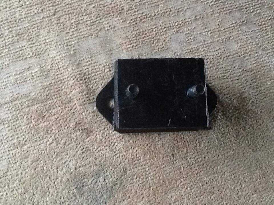

- Posts: 462
Re: HELP - Dolomite Sprint engine mounts
Here are some pics

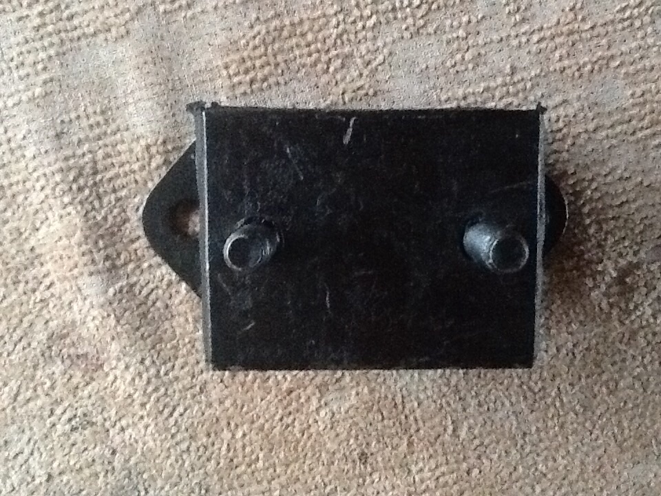

- Posts: 462
Or this way around ??

- Posts: 1034
- Location: Silsoe, Beds
I have found the same, there is a 1/4 inch or 6.35mm off-set between the two holes and the studs.
To level out my engine and gearbox I have one up and one down but presently seem unable to get the last two bolts in.
Are these new old stock or "repro"
As Mart said, they should be symetrical.
Probably why you are having grief fitting them.
Jon
Jon
- Posts: 8535
Hmmm!
I'll check out the mounts I have tomorrow (erm, today). If they are offset then I would mount them as the bottom pic with the studs offset to the top.
- Posts: 8535
I've checked and, as I thought, the studs are in-line with the holes.
Sounds like you are both suffering from repro rubbish then.
Its hard enough fitting the near side one when they are right if you are unlucky, Sometimes they do just plop right in.
If its out of alignment like this you are on a hiding to nothing. I'd send them back if recently purchased.
I have a suspicion TR7 ones are the same, (rubber bit) but use different brackets.
