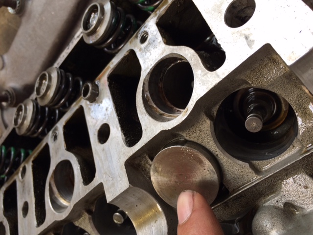

I've been a bit lazy on the updates lately. But I thought we where almost finished after installing the new exhaust. But now it appears the head I bought via eBay is not as solid I thought. The holes for what we call tappet buses (?) are worn out, which makes the buses tilt slightly. So we decided to prepare a new head ourselves (luckily I had one on spare). Since saturday is the first show, we are hurrying to get it ready for then...
