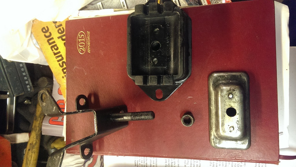

I'm half way through changing my unidirectional clutch on the od but I've forgotten how the gearbox mount goes back together.
I can't find a picture of the correct type anywhere and it doesn't make logical sense to me.
Does anyone have the diagram picture or at least a photo?

Yes but the rubber bit looks like its upside down. The indentations go underneath to stop the clamping dished plate rotating.

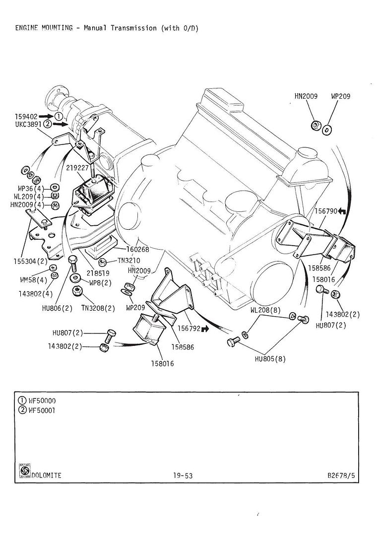

Ah ! Now that mount looks like the solid one that has been giving some people grief with noise and vibration from a recent thread.vraksianrebel wrote:I'm half way through changing my unidirectional clutch on the od but I've forgotten how the gearbox mount goes back together.
Have a read of this link plus the associated Restoration thread. I think the 1850 mount is the same as the Sprint one.
viewtopic.php?f=4&t=29990&hilit=sprint+gearbox+mount
Re: 1850 O/D gearbox mount
Thank you all so much. That was the perfect picture to work out what I needed. I suspect the mount will be fairly rubbish as the rimmer spec rubber seems to be all wrong but it'll keep me motoring for the time being. I shall look into the modification once I get home from the holidays.
