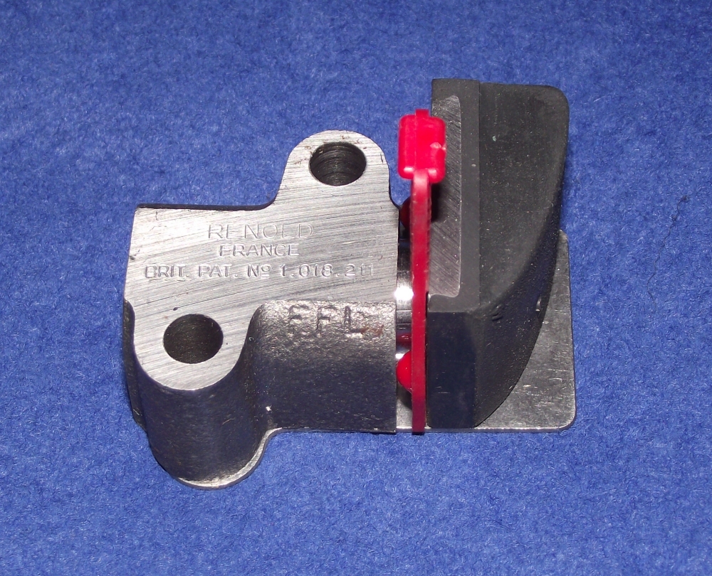

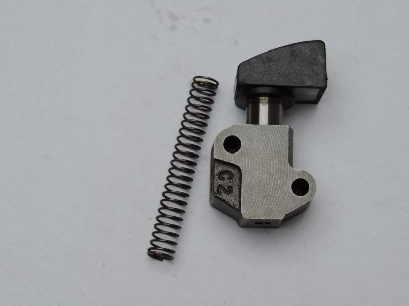

Its not so much the chain as the tensioner.
You need the Jaguar reynolds OE one, not the rolon one which suffers from pad detachment.

If you scroll down beneath the pic of the Barratt's competition tensioner, you'll see two other items.
One is the Rolon rubbish, (EAC3629*) but the other is more expensive because its the original Jaguar tensioner. Still available, for 18 pounds. (EAC3629) Notice how the pad is bonded around the edges of the plate. Its much more substantial than the Rolon thing, which just sits on the plate. Rob Beere has some Renold ones listed for sale, but told me he's sold out of them. I almost bought one of the Datsun 1600/1800/2000 ones, but decided against it when I noticed the pad ramp slope. Its steeper than the Sprint's chain angle and will wear quickly due to it applying pressure to a smaller area of the chain. Although the holes line up nicely, its .25" wider and taller than the Sprint's. Cheers,
Rob
Rob

Interesting that the Renold unit is made in france. Were they used on french engines and passed over to BL or made specifically by the for us? Were they the leaders in bonding rubber to metal?

The standard Jaguar one looks much better than the Rolon one, it is after all the pad coming unstuck that causes the problem. We have stock taking over the next few days but I will have a look at various examples next week for an up close comparison.
