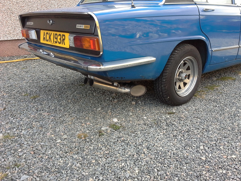

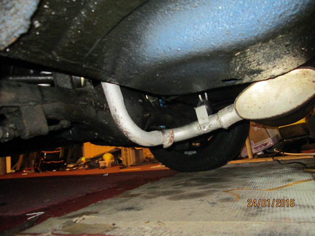

I recently needed to replace the "wobbly tail pipe" on my 1500HL which I must confess I never liked and felt it spoilt the looks of the back of the Dolomite. I was offered a GT6 tail pipe with twin exit pipes and it looked as if it would fit without too much trouble so a visit to the welding maestro at the local garage soon sorted things. The tail section curves up following the underside of the boot and is attached to hangers drilled into the well of the spare wheel, on first impressions it appears low but closer inspection shows it to be no lower than the diff housing.
- IMG_0501.JPG (283.03 KiB) Viewed 670 times
- IMG_0502.JPG (251.76 KiB) Viewed 670 times
- 2015-10-04 16.57.59.jpg (493.34 KiB) Viewed 670 times
- 2015-10-04 16.58.26.jpg (484.42 KiB) Viewed 670 times

Re: Could you fit a sprint exhaust to a 1500TC
Huge apologies, I didnt realise the photos would post up in massive magnification
No problem. I've resized them for you. The trick is to resize them before uploading them. To resize your photos just right click and select "Edit" which opens Paint where you can resize the photo. Don't forget to save the resized photo! I've found the sweet spot to be a horizontal size of 1024 pixels which suits most monitors. Ideally, it is best to upload your photos to a hosting site such as Photobucket or Flickr.
