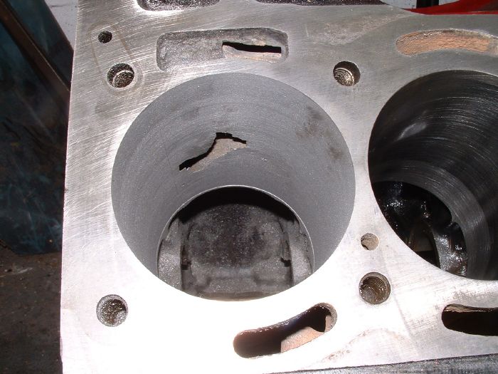

I believe this Sprint does stand for long periods but it is well maintained, so would have the correct antifreeze solution in it at all times.
Re: Water in the Oil
#17 Post by Jon Tilson »
Could it be fixed with boring out and a new liner I wonder?
Else its another TR7 block I guess....
Posts: 8532
#18 Post by Mad Mart »
Yep, that's what I'm going to do...or the M/C shop is.
TR7 block?

I took the block to the M/C shop on Monday to have a liner fitted. A couple of hours later I got a phone call from them telling me the block now has a hole in it...
They still had approx. .75mm. to bore out for the liner to fit. So that block is scrap. Luckily I am rebuilding a new engine for John (JTSprint) and he kindly said that I could use his old one. :D Thanks John. :thumbsup:

Ouch...
I'd be tempted to still stick the liner in...
Posts: 7250
#22 Post by Carledo »
Jon Tilson wrote:Ouch...
......and sell it to someone on ebay as a recon!
Come on Jonners, a liner in that block would crack in about 10 seconds from the heat differential. It's not meant to have water outside it or it would be 10 times as thick (at least).
Good coffee table curio though, the only Sprint with a wet liner engine!
#23 Post by Jon Tilson »
Should have added a smiley....
That is a worryingly thin water jacket. I know they did have a lot of casting failures on Sprint blocks back in the day....
TR4's are wet liner....the liners are about 1cm thick iirc.
