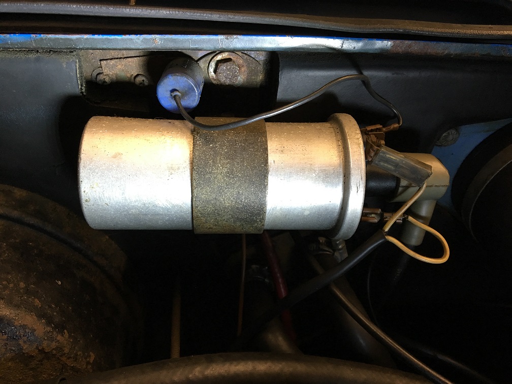

This is a 6V Lucas coil 15C6 fitted to a 1976 Sprint. I assume the ballast resistor is above the coil in the photo.
Would a straight replacement be the 12V Lucas DLB102 mentioned earlier in this thread?
I'm a bit confused to be honest.

The bit above the coil looks like a suppressor.

The blue thing is a suppressor to prevent interference on the radio. The ballast is usually part of the wiring loom.

I am looking after a Toledo for a friend and the ballast resistor in (my) car is a lump off stone attached near the coil.
