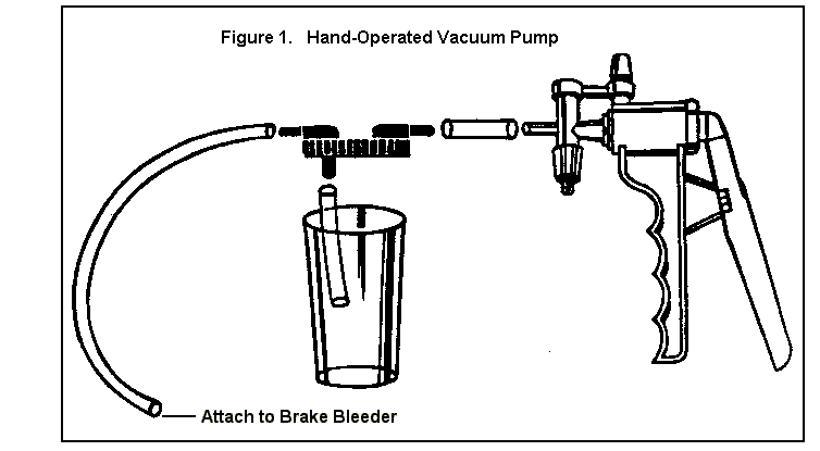

I think you need a bottle between the bleed valve and vacuum bleederSprintMWU773V wrote:On a slightly different tangent I have ordered a vacuum bleeder to do some brake work. I'll be interested to see how I get on as actually it could work very well for the clutch hydraulics. You attach it to an air line and another bit to the bleed nipple and then it sucks fresh fluid through. For the Mazda you can't fit the eezebleed to the cap and I can't always rely on the MK1 Wife to assist with some pedal work. I thought for £20 it was worth a shot.
On whether the remote bleed being high is a problem, I would say no. If you're forcing air out of the reservoir whilst using either your foot or an eezebleed then the position of the bleed nipple is the least of your problems.

No not for the air operated ones. You need the bottle (comes with) the hand operated vacuum type ones. I did consider one of these but then thought it might be advantageous to have one with a bit more oomph plus I have a compressor so no shortage of free air. The one which arrived today looks a bit like a spray gun and it collects the waste fluid in a bottle underneath.

To conclude the vacuum thing is s##t.
