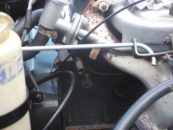

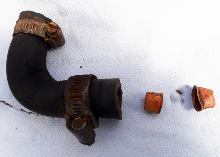

Well I went and visited Steve in Highley and he gave me some interesting pointers, which I cannot thank him enough for his time.
So today I tried to put my finger up (politely) into the water-pump to check for blockages and to feel for the blades of the rotor. No luck so I used a piece of wire with no joy, so off with the bonnet, off with the radiator and off with the water-pump. This was fine with the rotor blades in one piece and firmly attached to the shaft. So I took off all the rubber hoses and blasted the system with a garden hose, all clear with clean water. Then I blasted each hose and found the one from the heated inlet manifold to the pipe from the water-pump was blocked with two plastic caps! Attached are pictures.
Took the car for a long run out and it was certainly cooler at about 170-190 degrees and car felt better, even the gear changing as Steve thought the under-bonnet heat may affect the clutch fluid.

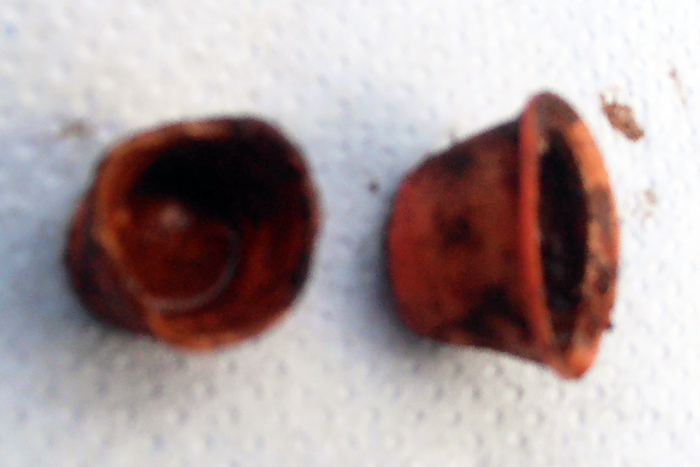

I have no idea where or how long the plastic caps were in the system? I overhauled the engine and fitted new hoses so it must have been me who allowed the caps into the system.

Well I have to admit, that's a new one on me! The plastic cups you found are similar to those used by reconditioning services to blank brake cylinders and the like in transit. What they are doing in your cooling system is beyond me!
But a blockage is a blockage! It just HAD to be a blockage somewhere, or else a cracked head! I'm just glad you found it BEFORE you pulled the head off!
