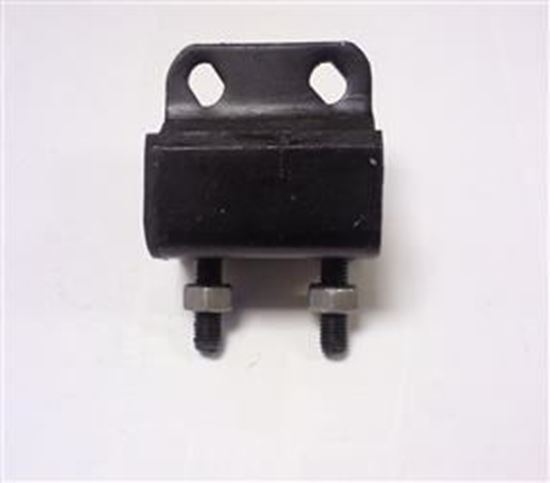

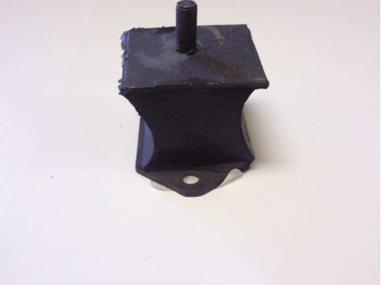

Stag, then 1850 mount for comparison:

- Stag em.jpeg (14.49 KiB) Viewed 1074 times
- 1850 em.jpeg (11.6 KiB) Viewed 1074 times

Stag mount looks very similar to the GT6 one.
Re: Sprint engine mounts
You're not wrong Steve, a much larger market for those as its not only used on the Stag and GT6 but also on TR8, TR6, TR5, Vitesse, Rover SD1, Morgan, TVR...

Whilst an 1850 mount may appear to look like an OHV mount, it is not the same, being much softer.

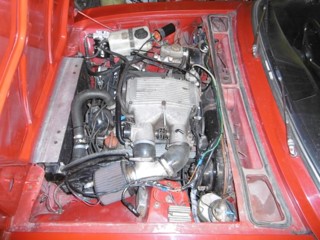

I asked Neil for a photo, should be below, it is a Vitesse twin plenum V8, quite rare according to Neil.
- 7D8BF3E1BD514B7BAE57FCB7625DA5F4.jpg (29.81 KiB) Viewed 1011 times
