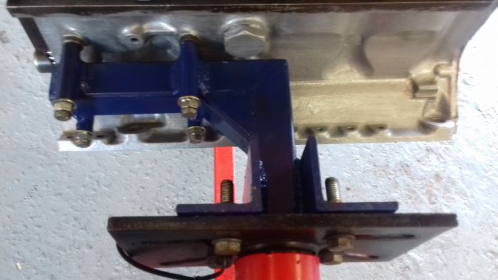

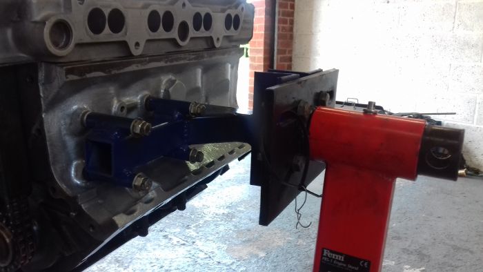

I've been evaluating James' prototype as I am in the middle of an engine rebuild myself. Why didn't I make one of these years ago? :roll:
It does exactly what it says on the tin. It's much more stable, especially when you have the head on as well, and it means you can get to the rear crankshaft oil seal plate. It also allows you to bolt on the flywheel, clutch and adaptor plates. It makes it a bit more difficult if you're painting the block but the pros far outweigh the cons.
James, you need to get cracking! :lol:

Mad Mart wrote: Thu May 03, 2018 6:00 pm I've been evaluating James' prototype as I am in the middle of an engine rebuild myself. Why didn't I make one of these years ago? :roll:
I like the neat bit of wire locking on the timing gear in the last picture.
