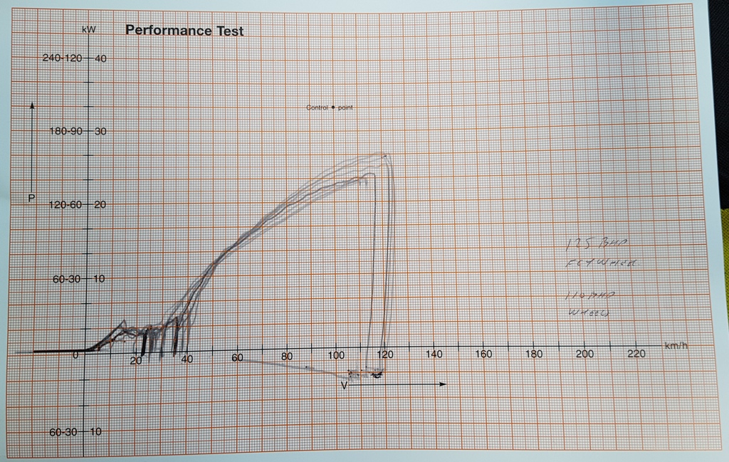

Done a tuning session yesterday afternoon, much easier with a rolling road as opposed to screaming up and down the road.
According to the Peter (the) tuner, I'm getting 125bhp at the flywheel and 110bhp at the wheel.
How good this is, I am not sure, however Steve (Carledo) who has driven my car during various stages will probably be a better
judge.
Re: Sprint 123 USB dizzy
#80 Post by soe8m »

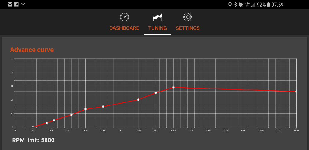

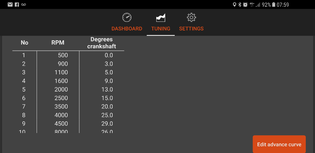

110 at the wheels is a strong std sprint what does have the cam timing correct. Normally it's somewhere around 105 at the wheels. Maybe you can gain by advancing a bit more? You are very at the safe side with that curve and you don't go backwards in degrees in the higher revs. You can but that's losing power and when it's done it's meant to be a sort of rev limiter. Cutting power by retarding the ignition at higher revs.

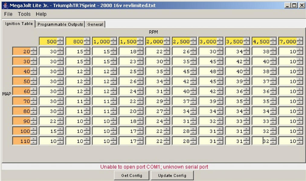

Not so far of these figures I was considering using with a megajolt.
