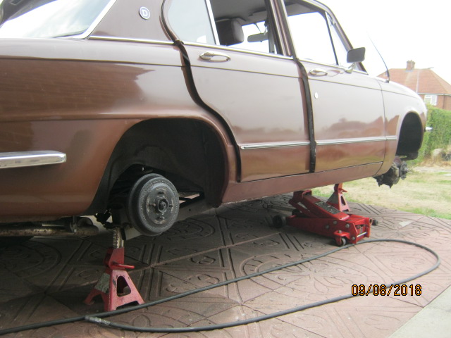

steering knuckle lower part rubbers were gone,cracked and few have gone somewhere :shock: got new poly`s ready to fit,but for now carmine-dolly has no steering,browny spot on now 8)
then...the drivers bottom ball joint start making a noise,changed that from carmine-dolly and all mint,got new ones here ready to fit,but first...mod to fit grease nipple
thats it for now :bluewave:

just tidy`d up the driver side bottom doors and rear arch,need cutting back to blend in
