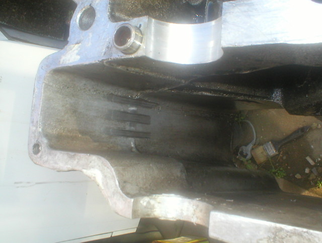

I've been helping a colleague with an early Sprint cylinder head job and I've just noticed what look like timing chain witness marks on the inside of the timing chain case that runs through the front of the cylinder head.
Is this normal ?
I do remember that when we bolted the camshaft sprocket to the support bracket the chain wasn't really as tight as I remember mine as it ran round the sprocket.
Thanks ,
timing chain marks2.jpg (67.77 KiB) Viewed 817 times

MIG Wielder wrote: Sun Jan 20, 2019 5:07 pm I've been helping a colleague with an early Sprint cylinder head job and I've just noticed what look like timing chain witness marks on the inside of the timing chain case that runs through the front of the cylinder head.
Is this normal ?
Thanks ,
No, at least my head does have anything similar and I can't imagine you'd design it this way. My original timing cover had a similar problem, with marks were the chain cut through. Tensioner failure, stretched chain, basically the chain making a bid for freedom.
Re: Timing chain witness marks ?
#3 Post by tony g »
Certainly caused by the chain, whether its the current one or a previous one is unknown I suppose.
