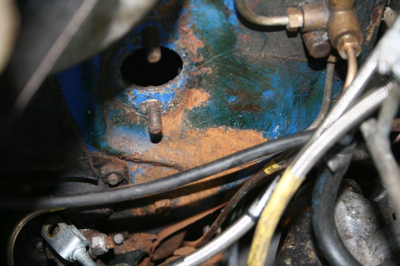

I got the time to have a look at the wet floor issue yesterday. I stripped back the sound deadening material from the bulkhead and found that although there is surface rust, there are no holes or weakened metal, so I'm pleased about that. Having looked carefully at where the water appears in the car I am 99% sure it gets in round the clutch master cylinder which I replaced last year. There is an air box drain right above it which makes sense to me.
So after cleaning up the rust and treating it I intend to fit a thin gasket with sealant between the clutch cylinder and the bulkhead and I hope that will sort it. We shall see!
