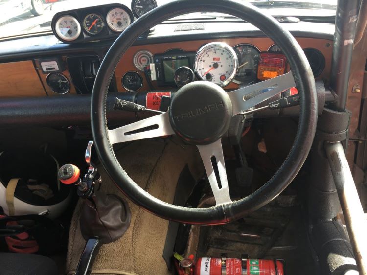

For those who need reminding when overdrive is on!!
#25 Post by gmsclassics »
I had to resort to the large warning light - 18W amber on the right side of the dash. The red was 18W oil pressure warning. Worked but I'm sure a smaller version would be fine in a road car.
