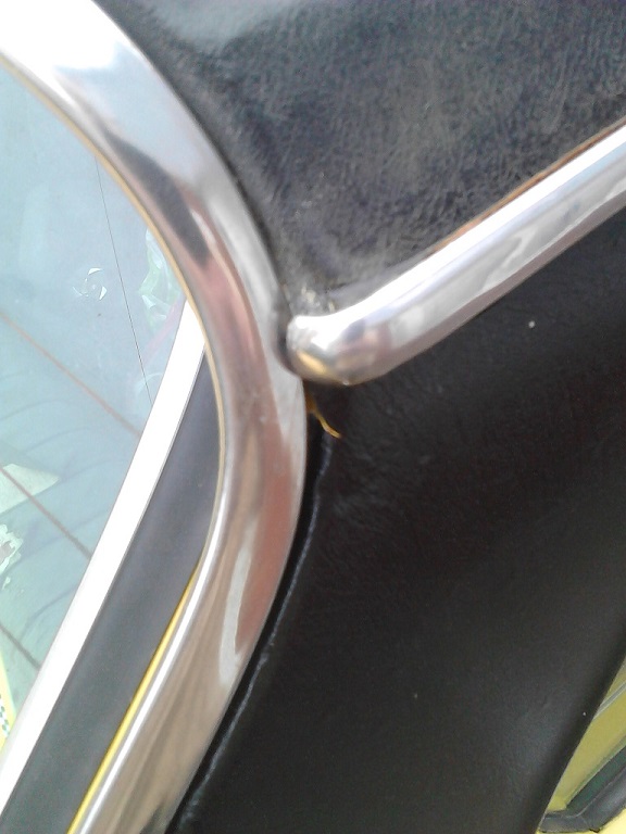

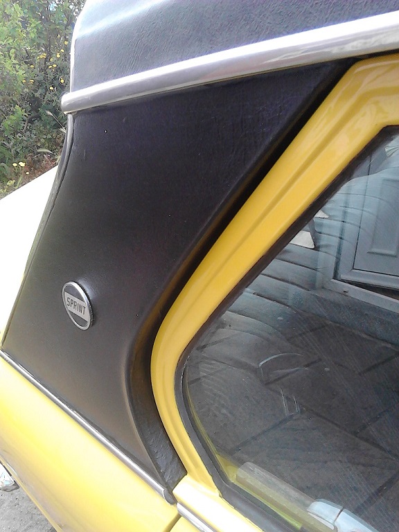

Ok pictures.
As you can see, far from perfect; certainly, if I'd paid a weeks wages for the job.
It did split a bit at the top rear because I didn't realize I needed the heat gun on that bit. So there, and an odd few other places, it needs a dab of black smoothrite with a fine brush.
And where it's stuck to the curve in the door jamb, it does nothing to hide the imperfections in the paintwork there. It's a bit thinner than the proper stuff.
But I find it acceptable for a fiver and half an hour's work.
Question is, what will it look like next year or the year after.
Graham

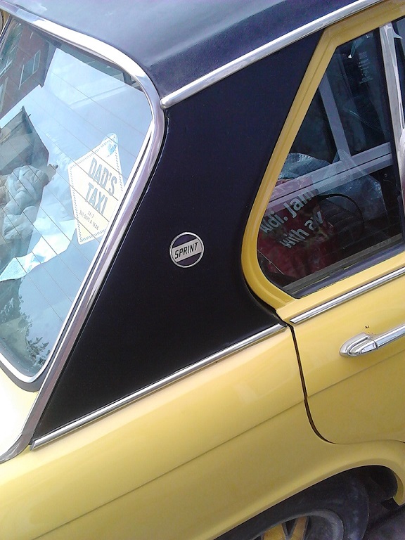

More vinyl turned up, so I did the other side. That went even better than the first side, but not so much better I'm going to re-do the first. There is enough in 1 m x 45 cm to do both sided if you cut it right.
