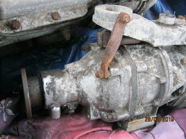

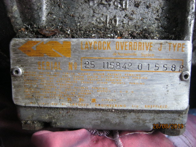

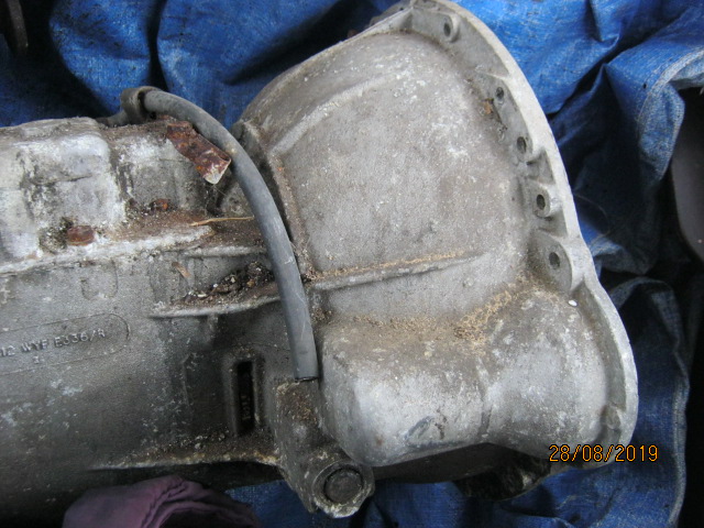

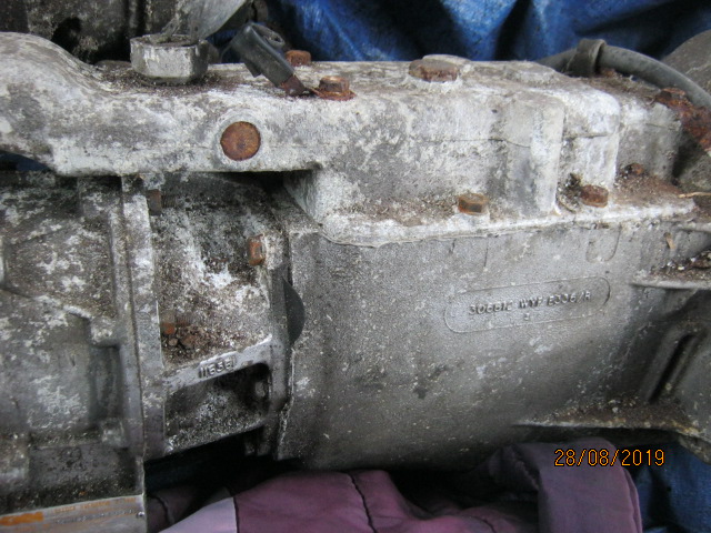

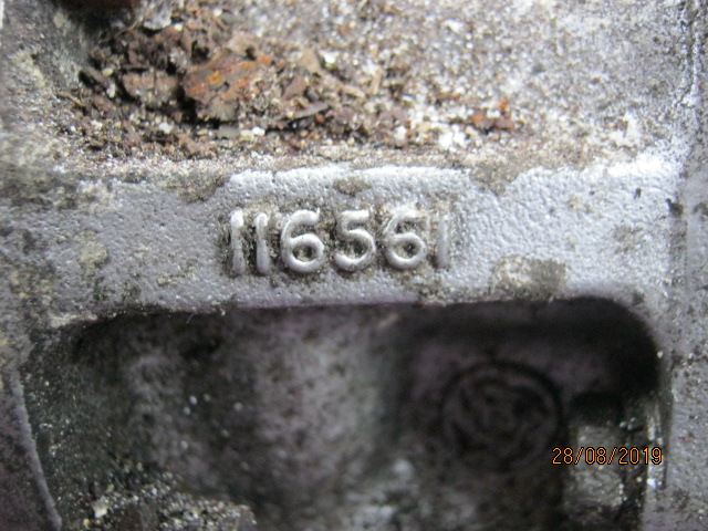

need some help on id gearbox....before i do a boo-boo again
thanks nic

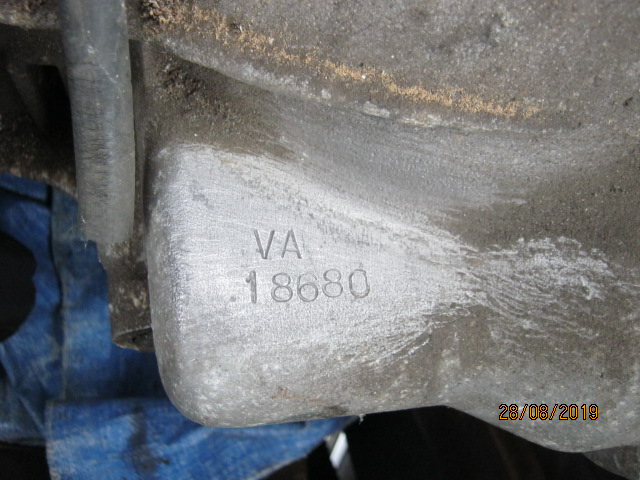

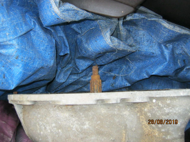

Well, the overdrive was originally fitted to a Sprint...look on the bulge to the driver's side of the bellhousing and you should find a number stamped into the casting. If it is prefixed VA, then it confirms it as a Sprint 'box (the length of the input shaft would seem to confirm this...)

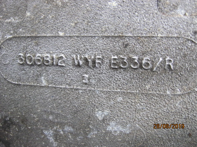

The numbers you've photographed elsewhere are just standard casting numbers.

thanks for pointing to the bellhousing and yes VA is marked on it
