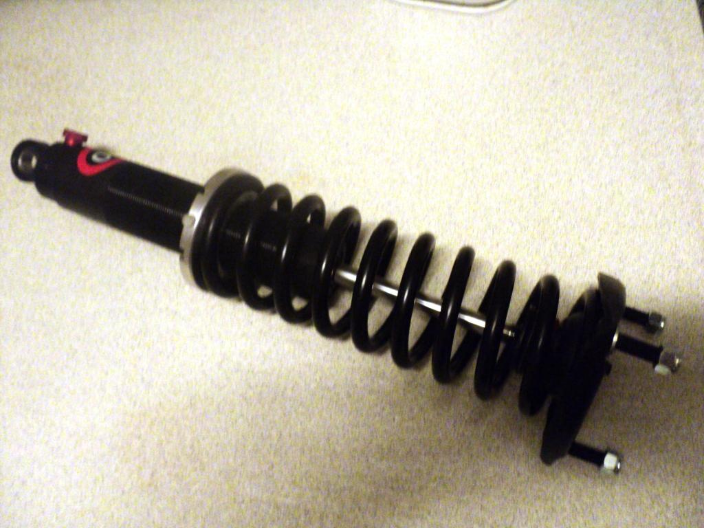

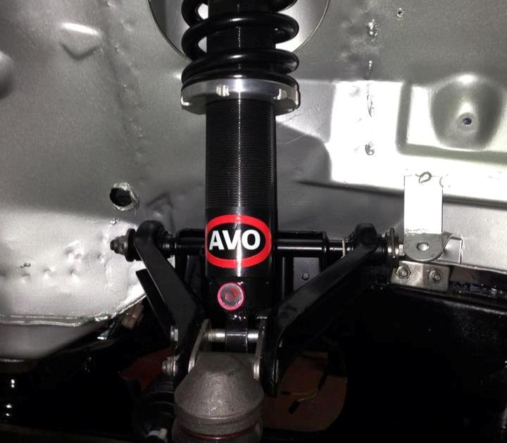

I had Avo's made with a uniball at the front. Those were fine on a rally car.
- avo2.jpg (48.31 KiB) Viewed 785 times
- DSC01631.JPG (113.07 KiB) Viewed 785 times
