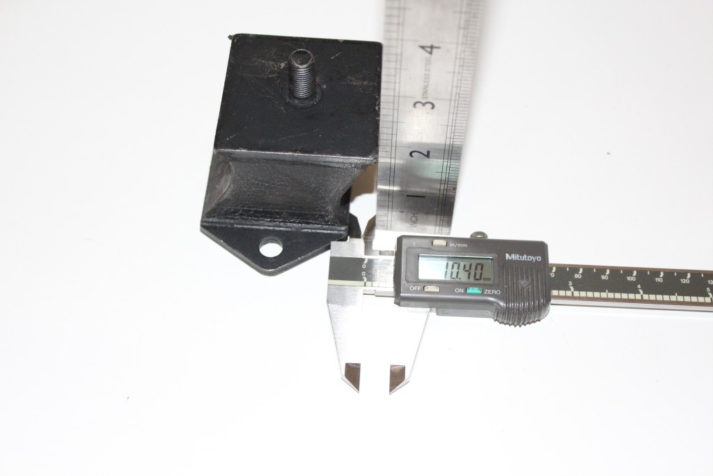

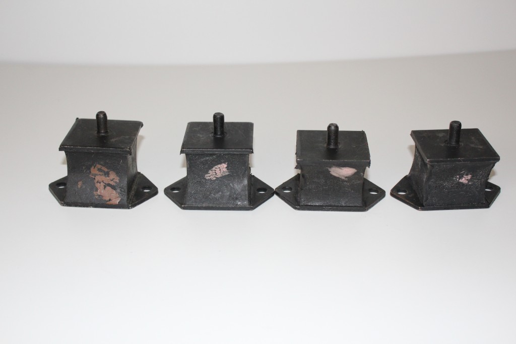

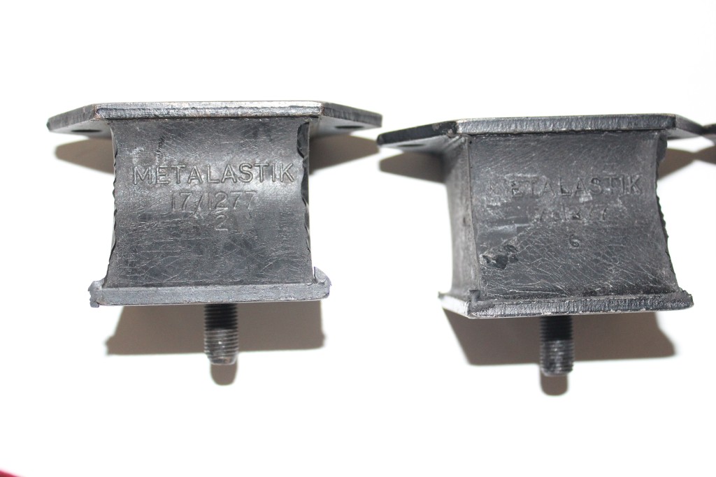

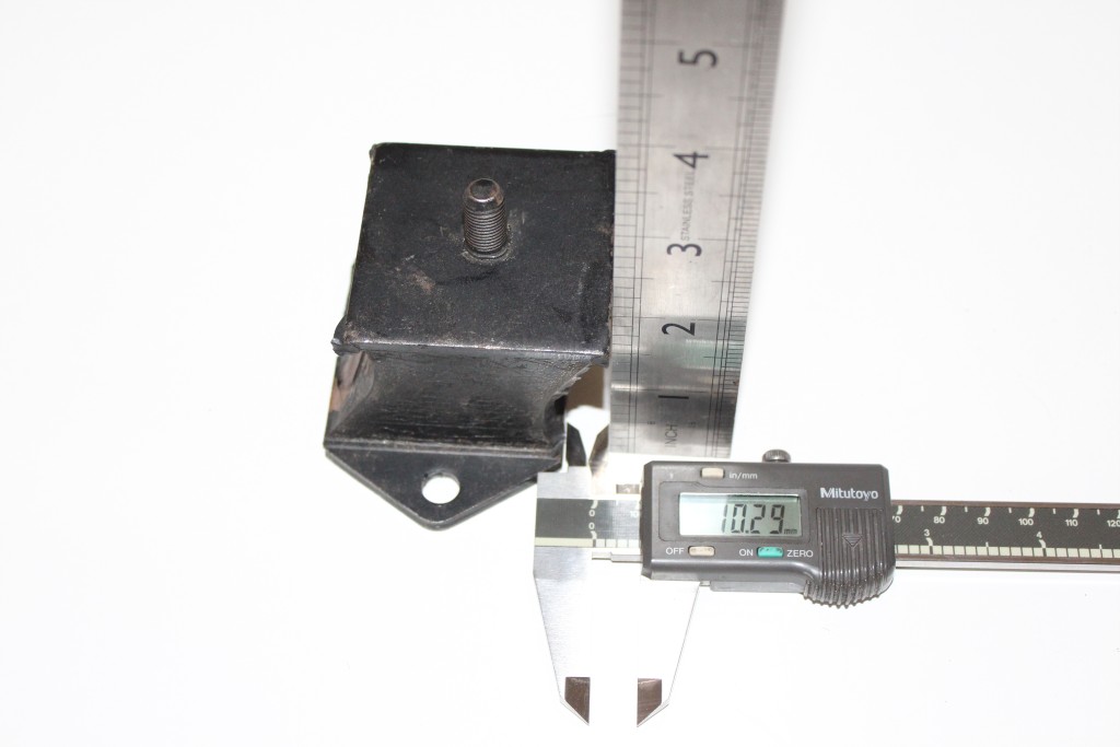

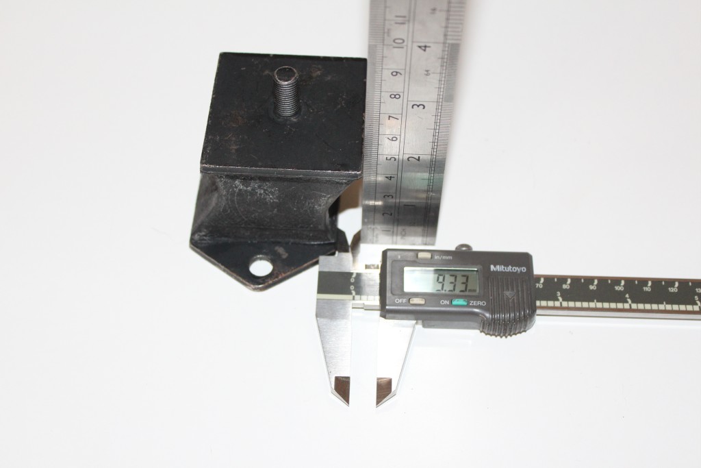

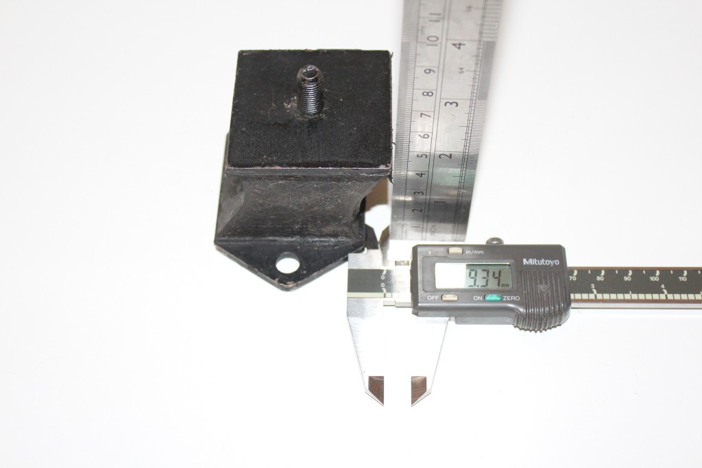

I have 4 off NOS Metalastik engine mountings, 3 off with pink(ish) paint markings (two of these have Mick Dolphin labels stating they are 158016 engine mount soft 1850 Dol), the fourth has a brown paint mark. The three pink marked mounts I can feel slight movement when I try to flex them, the brown marked mount has little to no flex by comparison.
I have roughly measured the offset on mine with the results in the photos below, hope this helps:

By the same measurement method as above I get 8.8, 8.3 & 8.5mm. All Metalastic NOS, soft, hard & hard respectively.
