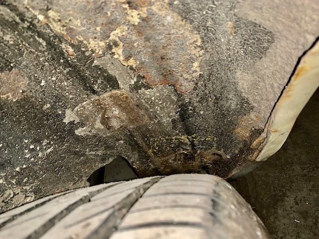

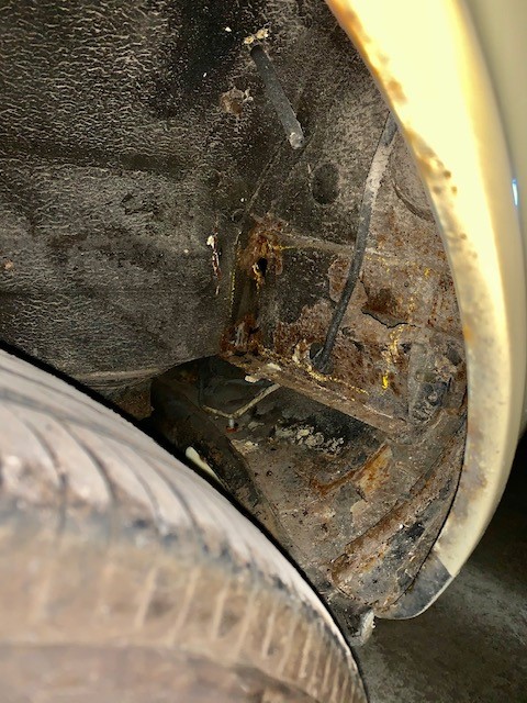

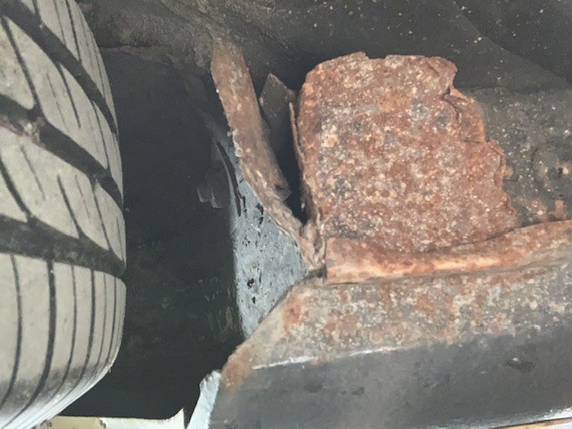

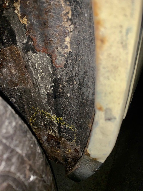

Hi all,
Pictures as promised...
Essentially there are three sections that need welding (yellow crayon):
1. Offside rear (seat belt anchorage) - this is two finger sized holes... quite far down the wheel arch, so not sure what this is to do with seatbelts
2. Jacking point area... ok, this looks bad.
3. suspension mounting, at the offside front (subframe mount) inside the wheel arch.
Whats your thoughts?
Thanks

On the face of it, it doesn't look bad. I'd need a visual inspection but seriously I've restored far far far worse!
That jacking point could be hiding some internal corrosion, they normally do but looks like it just needs the inner wheel arch knocked on and seam welding. I recon the join has been broken by the incorrect use of a two post lift.
The front rust is on the inner Valence, a usual rust spot and certainly not structural, in fact the subframe mount is fine. That is not a failure point and can be repaired without wing removal.
That isn't an official seatbelt mounting, they are all under the rear seats, not in the inner wheel arch, the hole is repairable but could hide some rust behind, metal looks ok so may be able to just plate it.
Where are you located?

Ok, So from a testers POV
1) the front subframe mount, the mount is fine the bit which is corroded is just an extension of the lower inner valance, a non structural afterthought. A repair section is available from the club for this frequently rusty bit. But it's no big deal!
2)Seat belt anchorage, now i'd have called this jacking point, or maybe inner sill end, both of which are pretty marginal as regards fails.
The point here is that there IS a rear seatbelt anchorage here, clearly visible, and it IS being used (there is a bolt in it) so, because the rot is within 30cms of it, it's a legit fail. But again, not difficult or expensive to fix.
3) the jacking point, again a marginal fail, the only real justification is the proximity to the front mount for the trailing arm, which will manage perfectly without this bit of tin! Once again, a good clout and a couple of short seams and it'll be good to go. But I might be inclined to investigate this bit a little further and make good if need be, after all, it is useful to be able to jack the car up safely!
In summary, you have been a victim of a tester who knows the RULES, but has no understanding of how a car is put together and which parts ARE actually structurally significant or load bearing. And very little common sense! In each case, the RULE he is so religeously observing is the one that says any corrosion within 30cms (12") of a point of structural significance is a fail. What is NOT written down but is assumed the tester will understand, is that the rotten bit also needs to be in a load bearing part!
As we've all said, find a more classic friendly tester next time!
