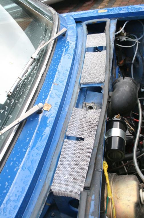

Carledo wrote: Fri Oct 23, 2020 10:00 pm On the Dolomega, I'm going to cover the holes in the heater plenum with "grille mesh" that lets air in but stops leaves etc getting in.
Just have to work out a way of getting the mesh panels to stay in place but still be easy to remove in case of need. I always remember that the poor b**ger that has to work on it next will probably be ME!
Steve, I'm ahead of you there - see photo. I used stainless mesh in three pieces. They are cut to just fit between the rubbers and have the ends folded so that they locate on the body. When the bonnet is shut the only visible gaps are where the washer jets sit. They stay in place but can be easily lifted off if I need to.

Bumpa wrote: Sat Oct 24, 2020 11:52 am
This is very similar to what has been done to my old one but using sheet aluminium. It has been done in two parts leaving the gap in the center for the latch. Slots have been cut as in your pic for the washer jets and extra slots and holes for the passenger side to allow air in for the heater. BUMPA the heater works ok. I asked about the restrictions on the heating and demisting expecting it to be reduced too much to be effective and I was told that it all works fine.

Wouldn't it be easier to attach mesh to the bottom of the slots in the bonnet?

cleverusername wrote: Sat Oct 24, 2020 4:14 pm Wouldn't it be easier to attach mesh to the bottom of the slots in the bonnet?
Thats what i have done.
Neat. Never thought of that.
