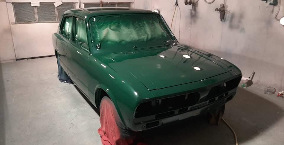

I'm in NZ and Toledos and dolomites are very thin on the ground out here so just getting a dolomite isn't really an option especially as I have had the toledo painted. truth be known I should have got a Dolomite rather than a toledo from the start but the wisdom of hindsight and all that
I can get access to a dolomite engine gearbox and subframe quite easily which makes this an even more tempting idea! I have taken the subframe out of the toledo everything else out - suspension, engine etc and put it all back in again - a lot of work but not difficult or complicated.

- Toledo - Emerald green
- Toledo painted 180121.jpg (33.77 KiB) Viewed 333 times
