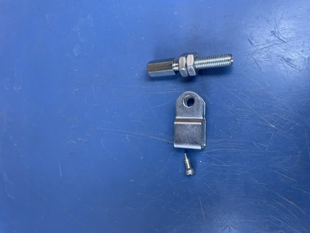

Robsport then suggested a TR7 cable which is the same length and has a similar bulkhead fitment. I can take the fitting the cable comes with to fix to the Weber linkage and make that work.

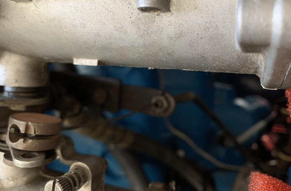

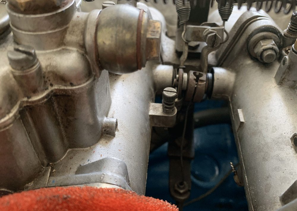

You can use a standard Sprint Cable- see the attached phots.
Philip

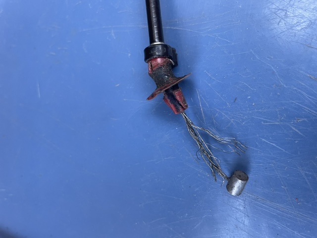

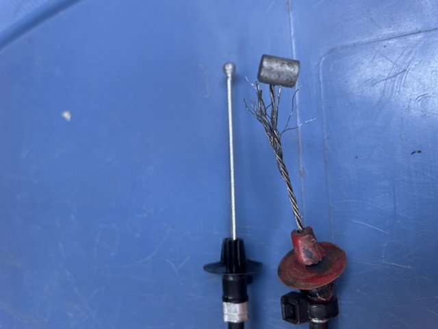

After extracting the offending cable it was clear to see what the issue was and that I was lucky it did not go completely when out on a run.
I cut the furniture off the end of the TR7 cable which was the same length as the existing cable, fitted it to the Webers and throttle pedal and had no issues at all.
Good work around.
Richard.
