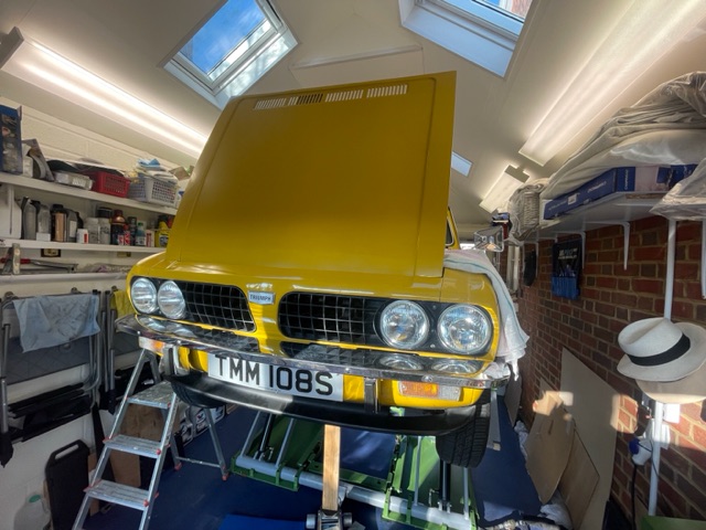

To update this thread……. but not fully
Yesterday my chum and I spent the day changing the 2 engine mounts (obtained from Chris Witor), together with the stay bar (collected from Rimmers at the spares day in Stoneleigh). Being of a certain age (65&70) most things take time, but to remove and refit those items took all day (& into the early evening!!). The old parts are believed original, so 45 years since the nuts & bolts were put on. We had a 1m lift so it was easier than using axle stands (we wouldn’t attempt it that way). All in all I can report that the work is well within the capabilities of an amateur mechanic (2 man/person job really). We were both shattered by the evening and now need to take the car out and get her really well warmed up to see if the judder on pulling away has disappeared. We decided that moving with the car to a cold climate was not an answer to our problem!!!
The Gearbox Mount was previously changed (the Volvo one suggested on this forum) as a first attempt to cure the judder.
I will update once we have giving the car a good shakedown drive.
Mike (& Phil)
Mike (& Phil)
