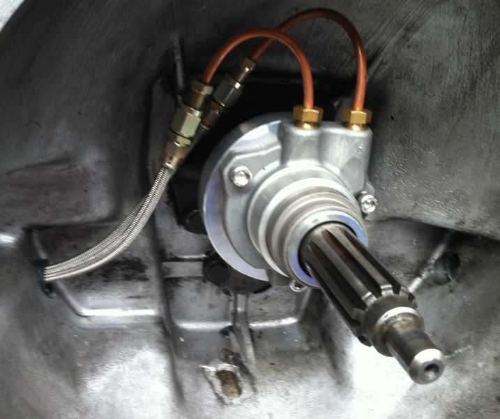

What i did on my setup, fitted the Aeroquip hoses straight in to the clutch cylinder and used 25mm pipe plugs in the gearbox where the cross shaft went and hoses poke through the pipe plugs
The hoses were already made up and had I plumbed them directly into the cylinder then they wouldn't have been long enough...you need to post some pictures Dave!

I used a similar setup on my racecar in 2013. I use a small piece of heater hose to protect the pipes where they went through the gearbox casing. I took the bleed pipe back up to where the clutch master reservoir is and attached with a cable tie. Never had a single issue with it. Excellent product. Geoff

#195 Post by new to this »
This is how I did mine
