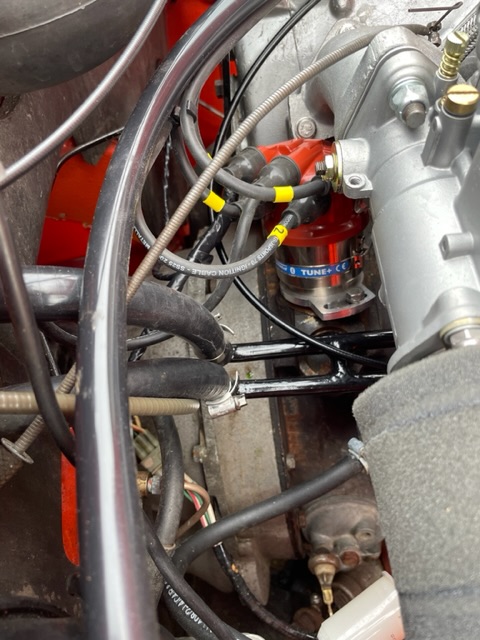

My Sprint has been in storage since October last year. I have not started it for three months. Three turns of the key today it fired up, and idled at 800rpm like it was started and running yesterday.
The 123 is a superb bit of kit that is hard to beat.
The down side is they are pricey.
Richard.
Richard, I was looking at the 123 option but the adapter problem put me off.
Yours looks very neat so how did you manage that please?
Russ
Russ.
A 123 distributor made it for me in Holland. Happy to pass on their details. Brilliant people.
Sent them the old Lucas which they used as a template.
R.
