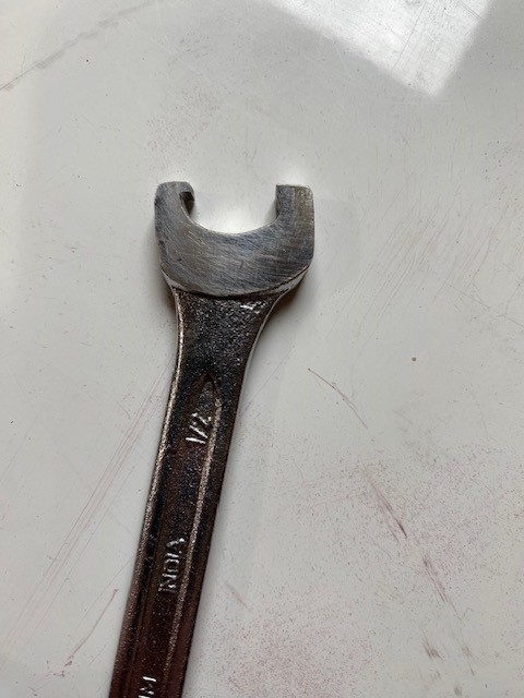

#3 Post by Malsprint »
In the absence of something off the shelf I modified a 1/2” spanner to do the job.

#4 Post by Malsprint »
Trim Spanner Photos

Malsprint wrote: Fri Jun 16, 2023 9:27 pm Trim Spanner Photos
How are you going to refit the trim ?

#6 Post by Carledo »
new to this wrote: Fri Jun 16, 2023 9:49 pm
Hook it over the top and whack it with the heel of your hand. Sure it hurts a bit if you've not practiced, but it doesn't damage the trim. For best results, start at the curve at the top of the A post.
Taking it off I just use a pair of pliers over thin cardboard, ie Weetabix box. Clever tool though, Kudos!
