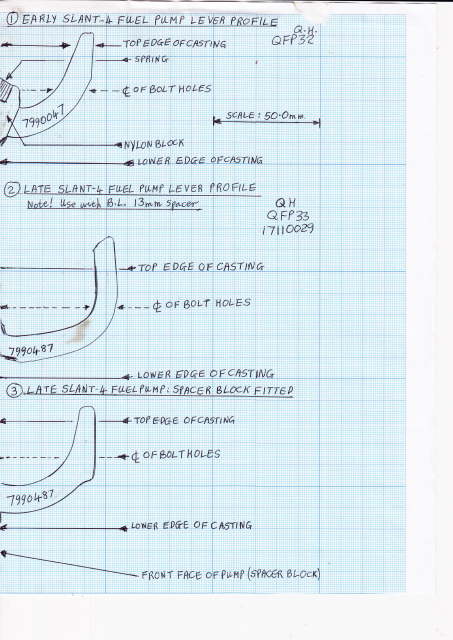

When I replaced my fuel pump some years ago I did a drawing of it and the Long Arm replacement ( Attatched )
If you print the graph paper out full size ( the squares are 1cm x 1cm ) and place the edge of the fuel pump on the left hand side you can check whether it is an early or a late version. Fig 1 is the early one. Fig 2 is the late one and Fig 3 is the late one fitted with the UKC 8523 plastic spacer.

Thanks for that - seems spacer is order of the day
