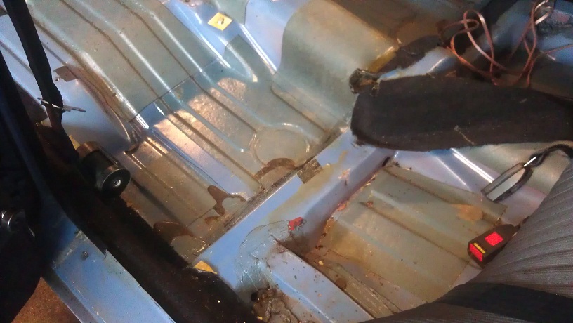

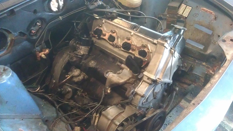

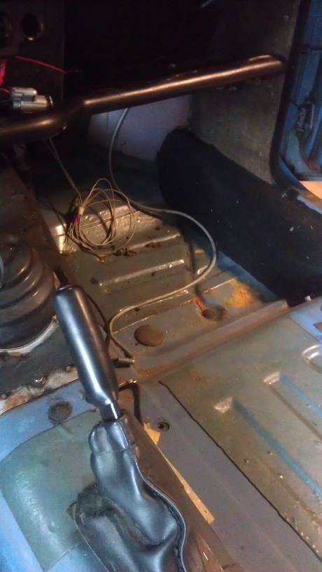

Here some pics of me working sprint.... :wink:
engine cleaned.jpg (146.94 KiB) Viewed 3681 times
floor front.jpg (111.94 KiB) Viewed 3677 times
floor back.jpg (118.46 KiB) Viewed 3677 times

Do i have to lower the suspension to allow lifting the complete engine/gearbox out? And the exhaust downpipe???? Hope i can leave that on the manifold :|
DavePoth
Posts: 5723
Location: Next to my Computer
Re: 1974 Norwegian sprint
#22 Post by DavePoth »
It can be pulled out with the suspension still attached - but you'll need to lift the front of the car to get enough of an angle.
Many people prefer to remove the car from the subframe - lifting the body off of the suspension and then pulling the engine, gearbox and front axle clear from underneath.

DavePoth wrote:It can be pulled out with the suspension still attached - but you'll need to lift the front of the car to get enough of an angle.
Ok. I think i`m going to lift the front of the car then. I want to keep it on wheels.
#24 Post by Jon Tilson »
Or you can pull the engine box and exhaust downpipe out together on a crane....
Just disconnect the propshaft and exhaust from the downpipe...and clutch slave from gearbox....just leave it dangling....speedo cable and various other little fiddly things like earth strap and starter cables...

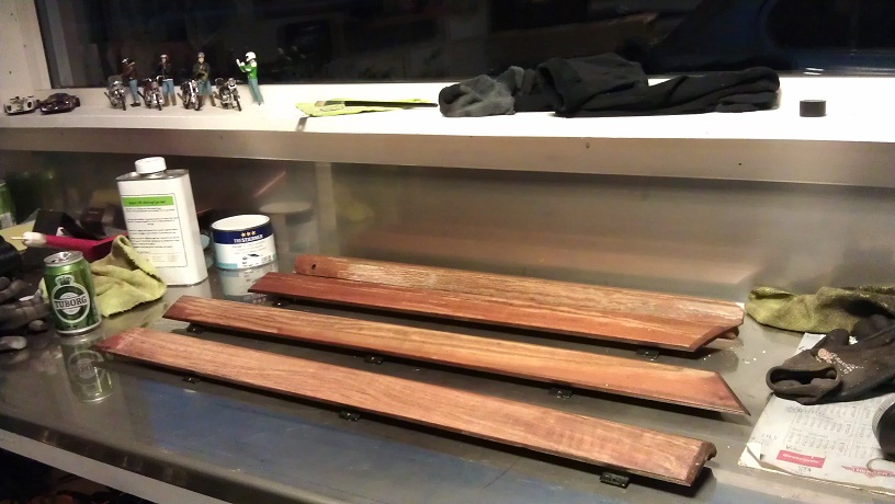

Hard job restoring wood door panel :? .......Use broken piece of glass, to scrape off the old cellulose.
....and yes....i like to eat the green lettuce side of my beer :mrgreen:

as long as you stick to drinking the tuborg and not the laquer/thinners in the other bottles. :)
I enjoyed the hell outta doing he woodwork ! such a nice, simple, achievable job with awesome results at the end.
you are doing great work here, excellent photos.

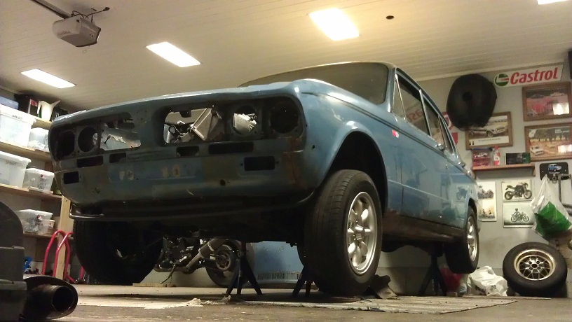

Hi.....Cheers 8)
Thanks alot for the feedback.......... :bluewave:
Soon the car is ready for the welder/painter man :wink:
roof left back.jpg (86.42 KiB) Viewed 3260 times
Front stripped.jpg (126.83 KiB) Viewed 3263 times

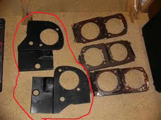

Where can i buy this repair panels?
Flyfisherman
Posts: 980
#30 Post by Flyfisherman »
according to the parts book - these are not avaiable as individual parts as they are as one piece - inner front valance
http://www.rimmerbros.co.uk/Item--i-814535
I would contact:
Geoff @ Winsinternational - +44 1342 327018
Fitchetts +44 1952 619585 / 620434
Quiller Triumph +44 20 8854 4777
Regards
