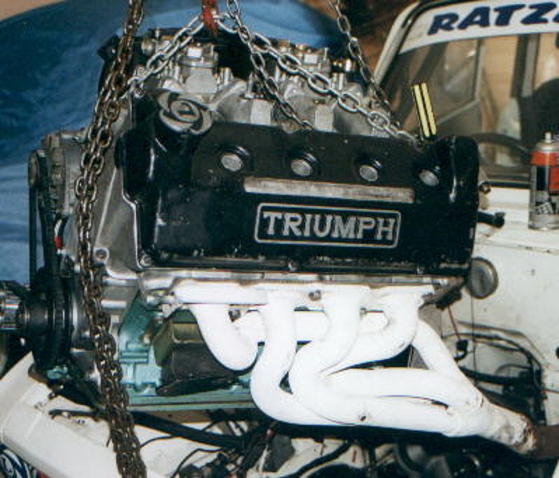

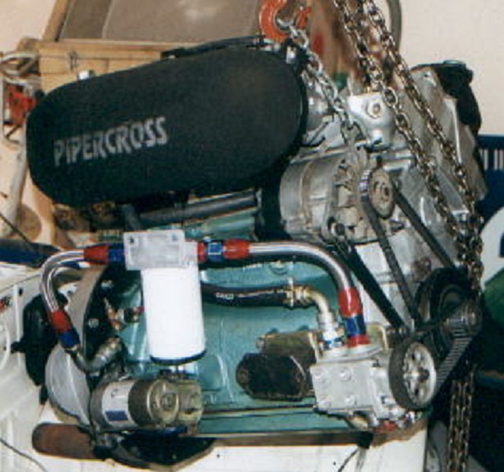

A number of years ago when I was racing my Sprint I bought a F3 motor from Holbay. It had the oil filter housing machined off the block as it was dry sumped and had a remote filter. This allowed me to fit a small Japanese starter motor where the housing had been. Doing this meant I could remove the massive Lucas starter which gave me a lot more room to build and fit a tubular exhaust header. It would also be possible to stand the motor up a little giving a bit more clearance. The works engines still managed in excess of 210 hp with the cast manifold so it cant be that bad.
Grelley
grelley
Re: Sprint Headers
#26 Post by grelley »
Found a couple of pictures of what I am talking about
