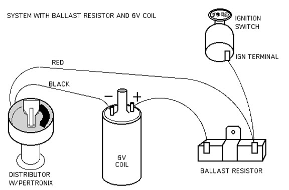

Re: Misfire Again
Like this then?
- ignition connection.jpg (65.2 KiB) Viewed 1731 times

Re: Misfire Again
Yes. And connect the white yellow direct to coil positive also. That is your start bypass.
