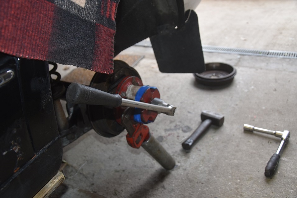

Richard the old one wrote: Tue Jun 23, 2020 2:14 pm It did take me some time to work out how to stop it turning but see attached photo it worked for me.
What about the side force this puts on the wheel stud?
I'm interested because I've a related problem of how to stop the front hubs on the Herald turning as I do and undo the nuts holding the wire wheel hub adaptors.

GrahamFountain wrote: Thu Jun 25, 2020 12:25 pm
Graham
Agreed on the possibility of stud damage from the crowbar technique, though I do use it often on moderns which mostly have (relaceable) bolts rather than studs, it's pretty suicidal to do it on 3/8" studs! Find another way is my advice!
2 choices again! (I don't think the phone camera will help here) 1) get SWMBO to stomp on the brakes while you do it 2)Yes it's BFMI, but this sort of thing is where a "windy" gun (or it's battery/electric equivalent) REALLY comes in useful! I've found from experimenting that an average windy gun at full chat, tightens to 160 lb/ft but most have 5 or so levels of output below that so you CAN get more like the right tightening torque rather than just snapping the studs!

#26 Post by sprint95m »
Carledo wrote: Thu Jun 25, 2020 1:32 pm Find another way is my advice!
In conjunction with the puller, I would use a suitably long length of angle iron, located on two studs, as a lever against the ground.

sprint95m wrote: Thu Jun 25, 2020 8:26 pm

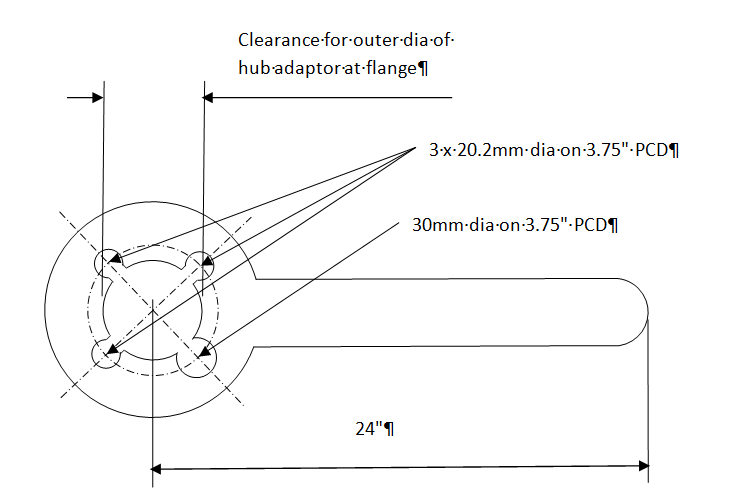

Spreading the load over two studs has to be twice as good. However, for what I want on the Herald hub adaptors, the nuts are so close up to the main shaft. So anything straight must miss the other nut. I did wonder about a thickish flat plate that bares on the ground at one end and curves round 2 or 3 nuts, with 2 or 3 slots/holes the width/diameter of the across points size of an 11/16ths AF nut. But I reckon it's beyond my abilities to make, and needs a fab shop.
Looking at the picture of pry-bar, if it bent more, a bit near the tip might contact the side of the next nut along. That would take some of the load at least.

If I was to get a tool made for this job, I think it would look something like the attached drawing. But I doubt it's worth it to me. A similar tool for use with the Canley puller would just want 4 holes 20.2mm diameter and a center hole to clear the diameter of the tool's boss.
