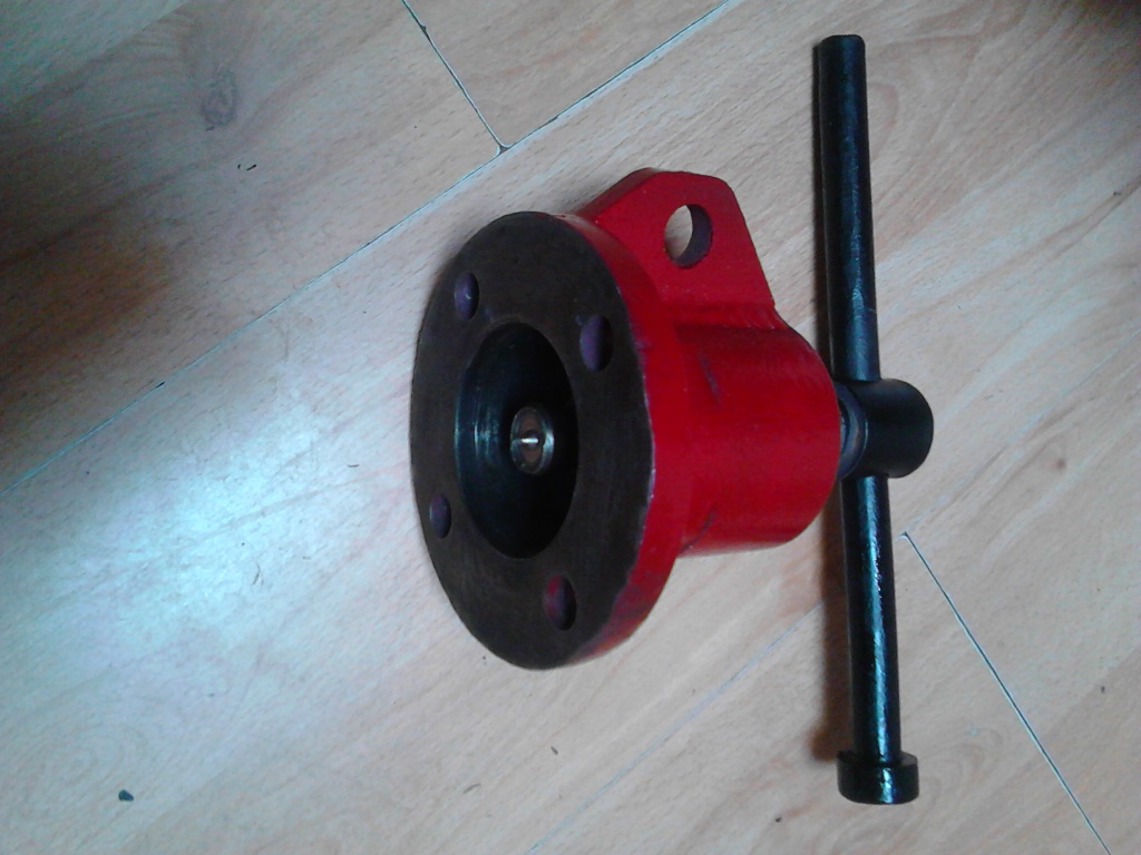

I got this tool off eBay for the Herald, which is supposed to be a copy of the churchill tool for that car, made by a local firm for the guy I got it from. I think that's a functional copy rather than identical copy.
If the tool he had copied was the VL CHURCHILL/BMC FACTORY SERVICE TOOL S356C, it's also supposed to be for the Dolomite Sprint as well. So I'm hopeful it'll fit, though I haven't got around to offering it up yet. The last time a stud got broken (think it was the welder that did the inner wheel arches), the half-shaft had to come out and it were a real palaver.
The hole underneath is 2.5" diameter to the step, which is about 0.24" in, and 2.4" diameter to about 1.3".
Graham
Graham

I believe that my hub puller was purchased from Canley Classics but that was a long time ago so I will attach a photo of it. I purchased it after attempting to get hubs 1500cc hubs off at the local garage using their press without success.
What I have found is if the hub does not come off with the first attempt slacken it off and retighten the stud nuts that are holding it, the puller, onto the hub as the first attempt may have pulled one or more of the studs a bit further into the hub which then results in the pull not being square.

The question I have about the Canley hub pulling tool vs the Churchill one, is how you stop the tool and hub turning as you turn the screw? Is the handbrake good enough?
The copy I have, like the Churchill one, has flats for a v. large open ender, plus mine has a web with a hole in a bar should fit through and bare on the ground.
Graham
Graham

'kin enormous stilsons around the puller, or if you are a mental case and tighten the forcing bolt up with an air gun (what sort of idiot would do that?) , very very thick gloves and hold onto it! (Don't try this at home!)GrahamFountain wrote: ↑Tue Jun 23, 2020 12:46 pm The question I have about the Canley hub pulling tool vs the Churchill one, is how you stop the tool and hub turning as you turn the screw? Is the handbrake good enough?
Graham
