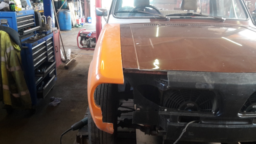

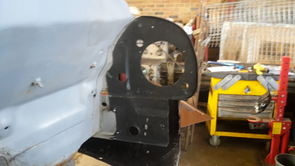

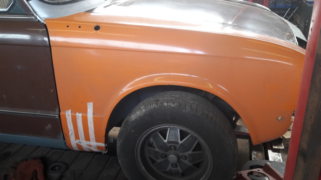

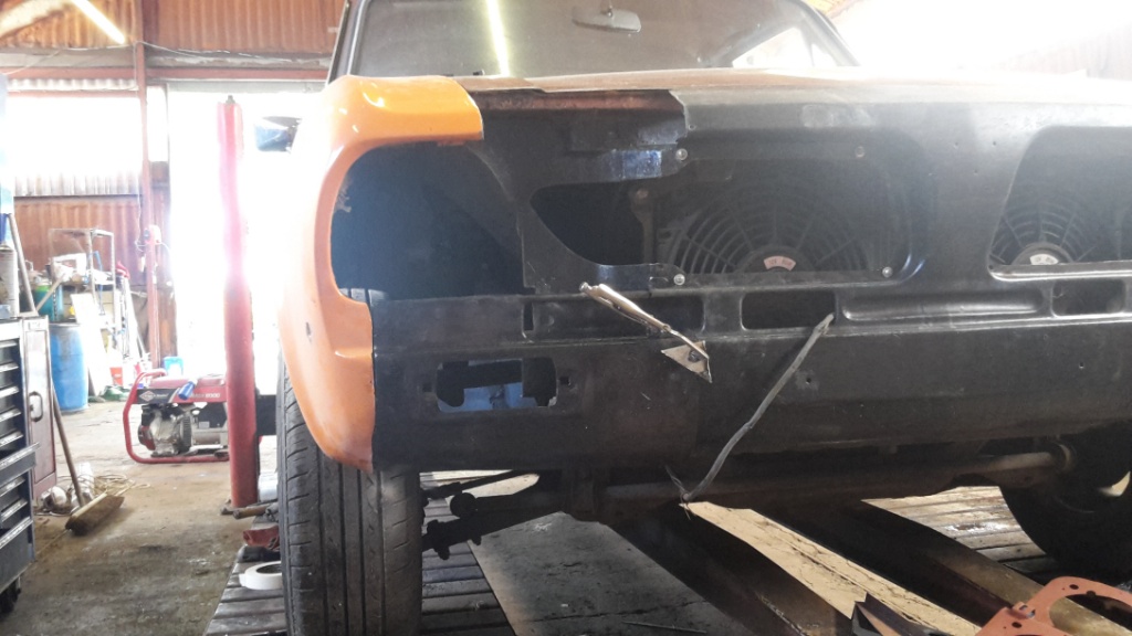

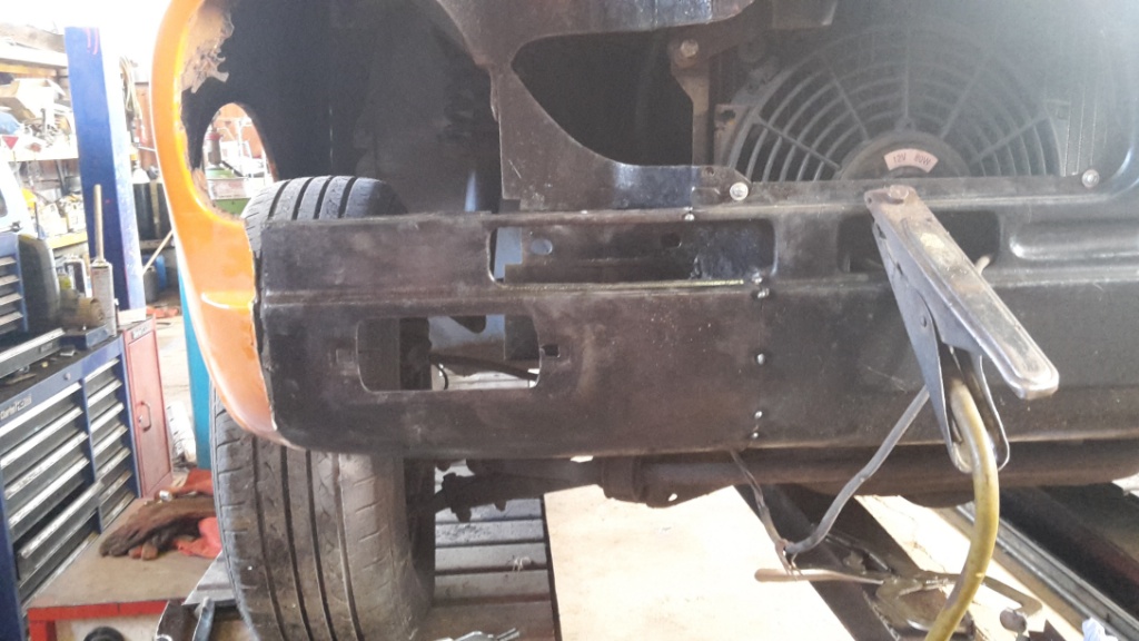

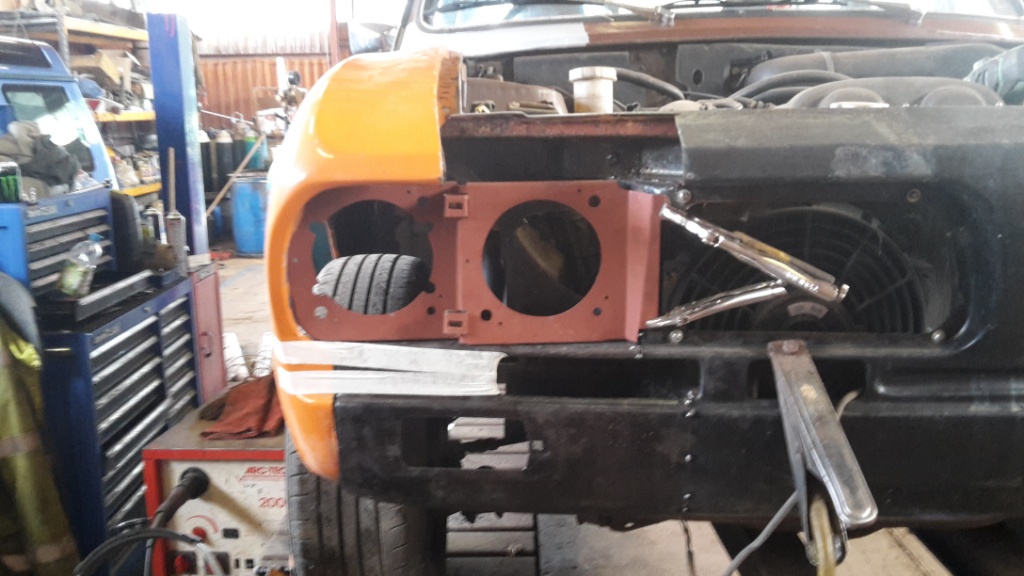

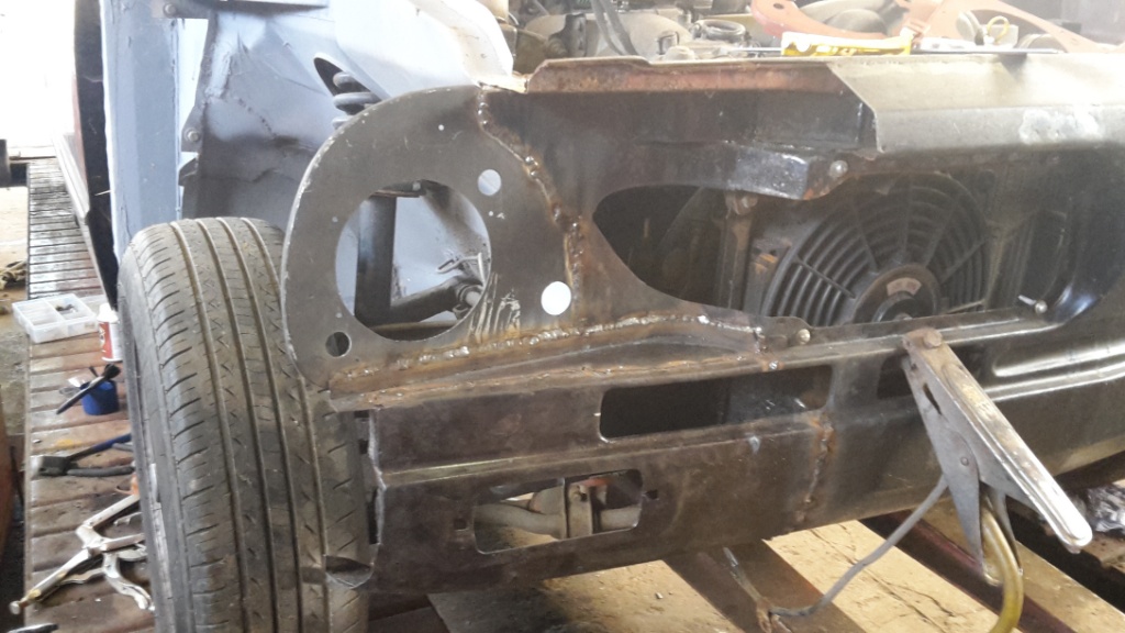

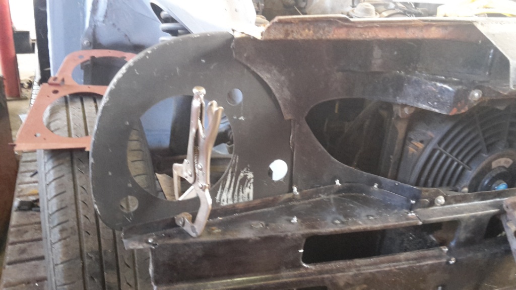

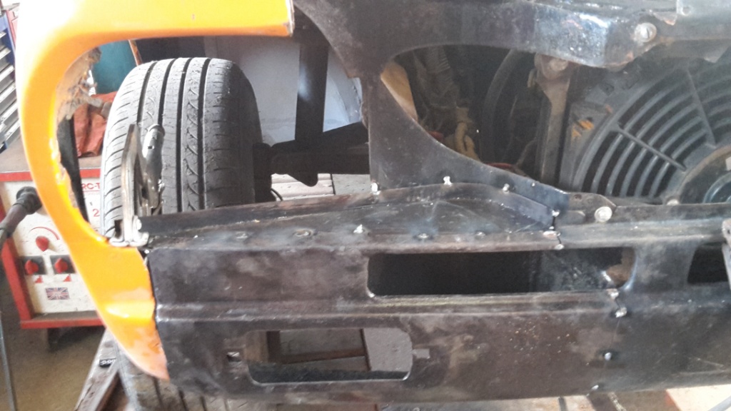

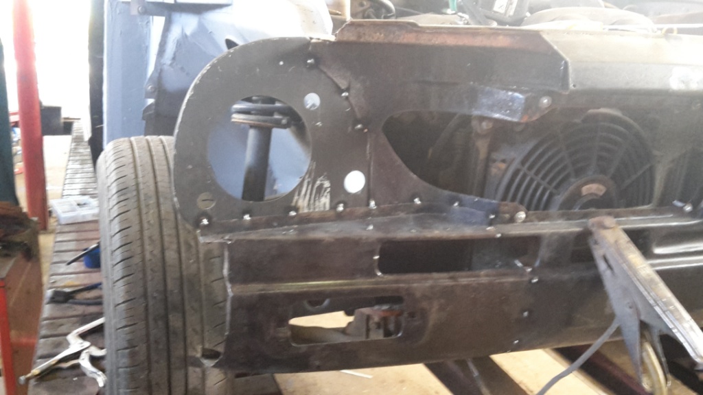

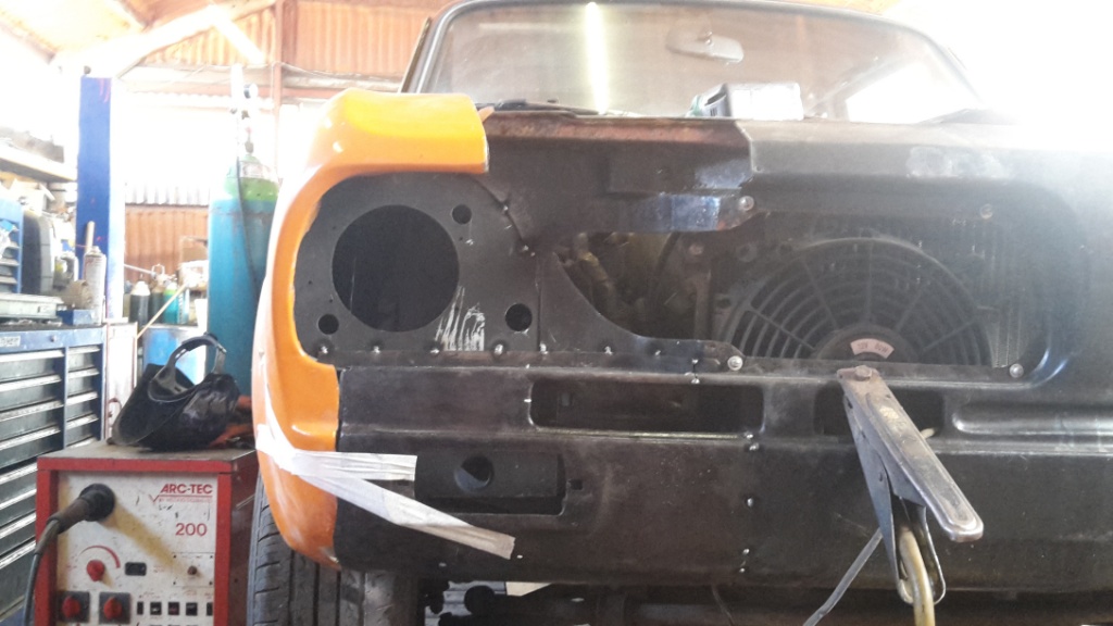

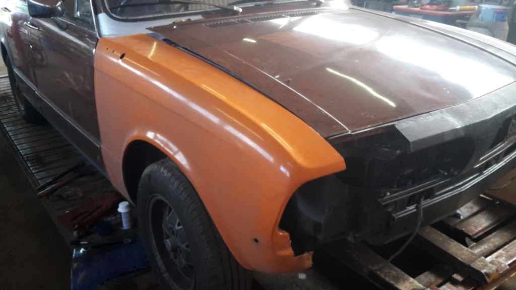

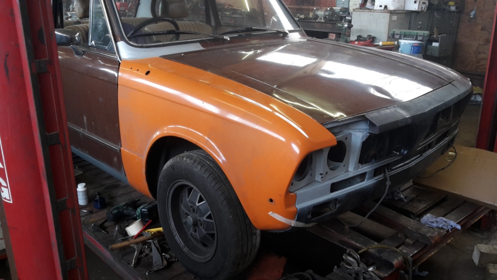

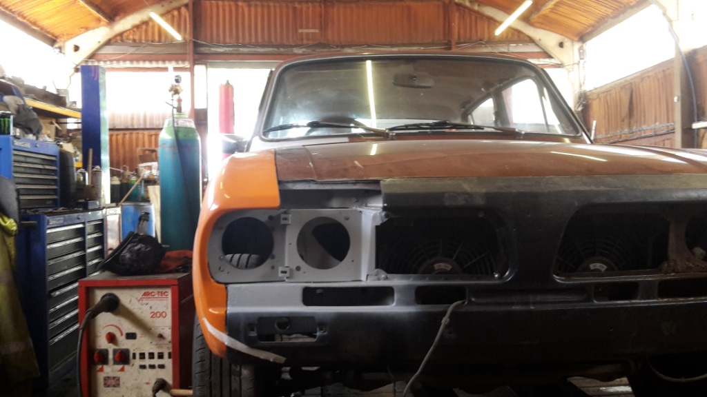

Today I've dry fitted the front wing with screws and sorted out the inner valance. Welded in the front valance and fitted the headlight mounting plate. Just got the eye brow to finish off on the driver's side and weld the wing on.
philgroom

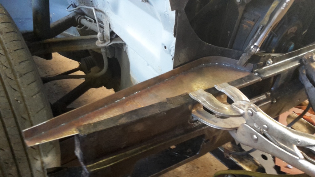

#213 Post by philgroom »
Last couple of pics from today's work

Solid!

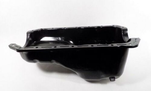

There are some pictures of the sump on page 1 of the thread. Maybe someone can identify what sort of is.
Mazda 323 oil pan.jpg (11.07 KiB) Viewed 39979 times

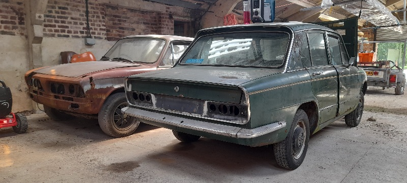

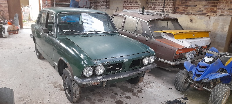

So after many years I'm back on to getting the dolomite going. Unfortunately I left it too long sitting on bad ground and the underside has really suffered. I've managed to get the eninge running and checked drive train over and have acquired a new shell to transfer all the parts to. I will keep adding to this thread and hopefully people will keep enjoying it.

#220 Post by Philgroom »
New and old

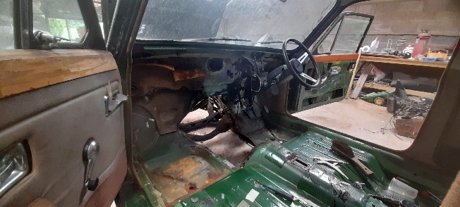

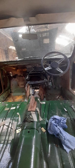

#221 Post by Philgroom »

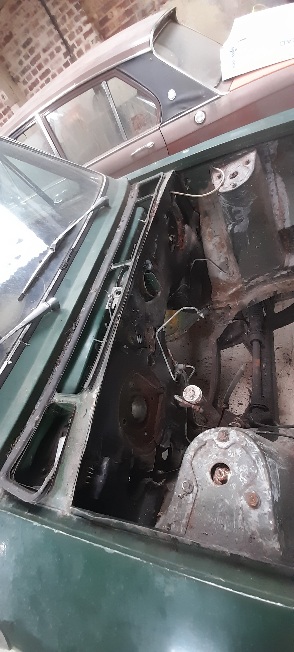

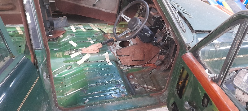

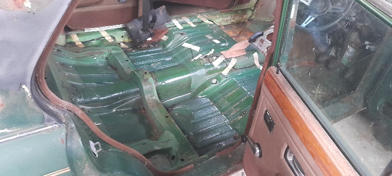

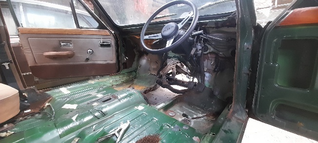

Started to strip donor shell down. Front seats and carpets out. Heater matrix and gearbox tunnel removed. Handbrake lever removed. Front half of wiring loom taken out. Also got most of the parts out of the engine bay. Just clutch master cylinder and insulation to go. There's a small rust hole under where the brake master cylinder is and an on old repair on the throttle pedal mount that's going to need some attention.

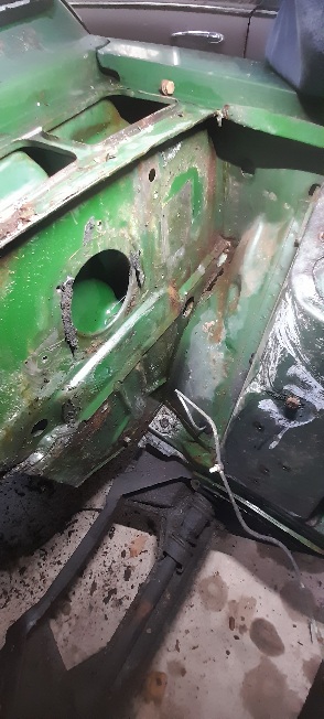

#222 Post by Philgroom »

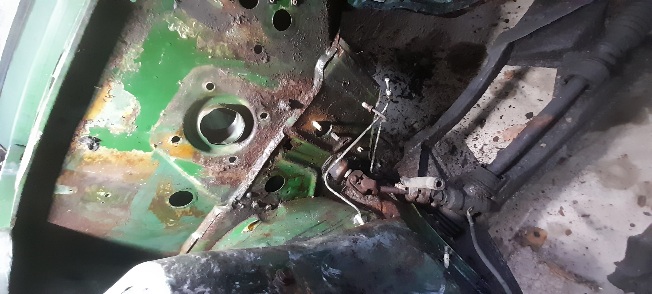

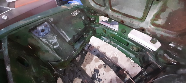

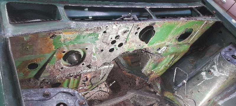

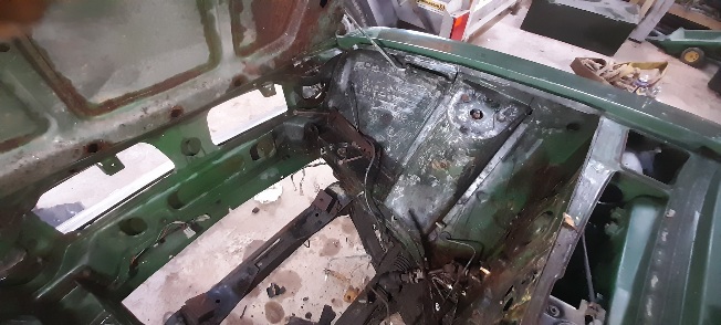

A bit more progress on the green shell. Got it pressure washed and finished stripping the engine. Git a few holes in the firewall and left hand side behind strut mount. Left hand bonnet mount also needs a repair but apart from that engine bay is pretty solid.

Its just going to be a lot less work to get the green shell repaired than the brown one. It did take me ages to decide to replace the shell as its almost like getting a whole new car with different personality.

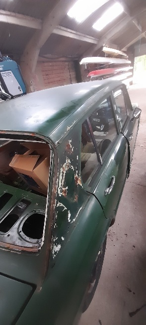

Philgroom
Posts: 49
Joined: Sat Aug 05, 2023 6:17 pm

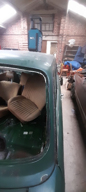

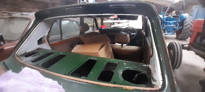

#225 Post by Philgroom »

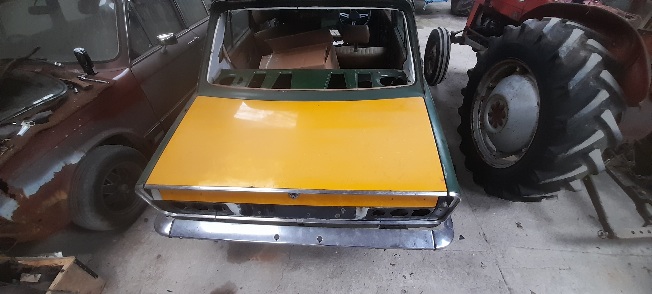

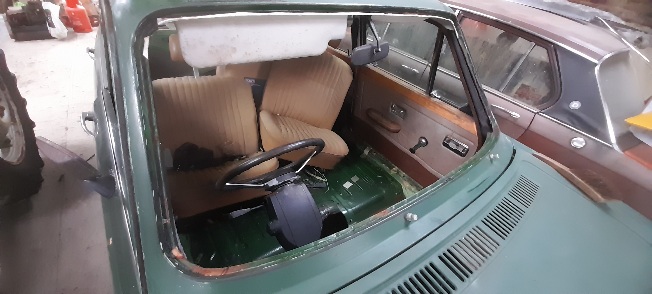

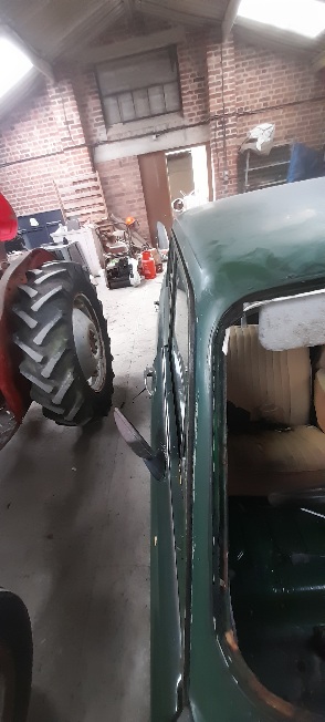

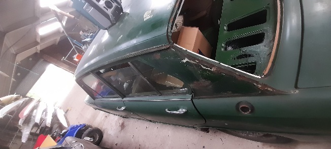

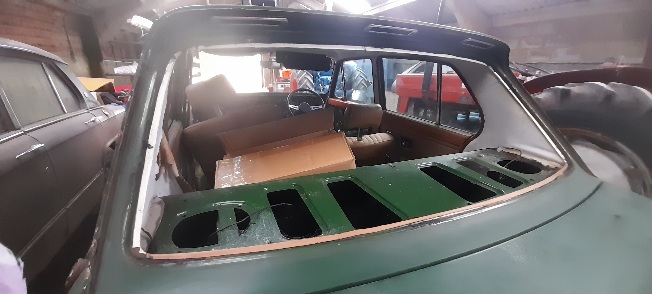

I've got the front and rear windows out and the chrome off the car without damaging or twisting it so hopefully it will go back on. Only a bit of surface rust around front window. Also put my best boot lid on and adjusted to fit properly.
