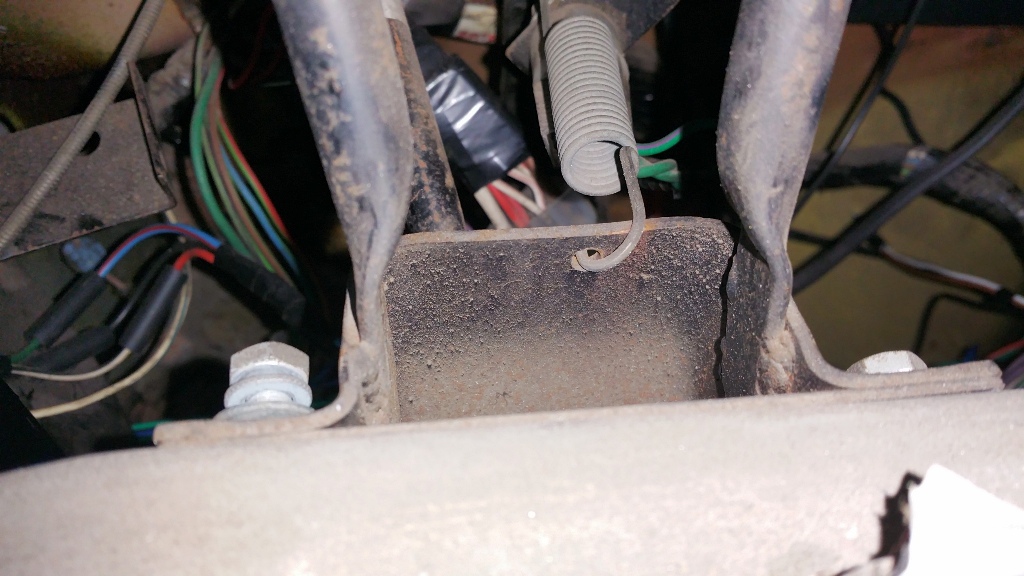

Loose bolt noticed (probably the stereo loosening up everything)
All three (speedo, heater, choke) cable grommets are letting in some water,
There was a hole in the top at the wipers which probably done this,
Not sure much can be done at the moment, other than a bit of jenolite and hammerite.
More water is coming in from the tunnell back area, (pic to follow) theres a big hole there)

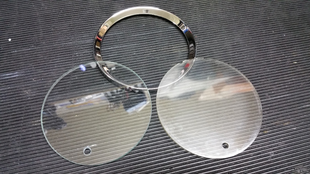

I was showing the cleaned up dashboard and gauges to Mick across the road,
and he commented on why the speedo one is scratched.
Being easy to take out I removed the chrome ring and placed the plastic
window in his hand, immediately he left my premises and went to his shop
across the road with the speedo window.
Mick returned 5 minutes later with,
Being a glass merchant, it was too easy for him to sort out.

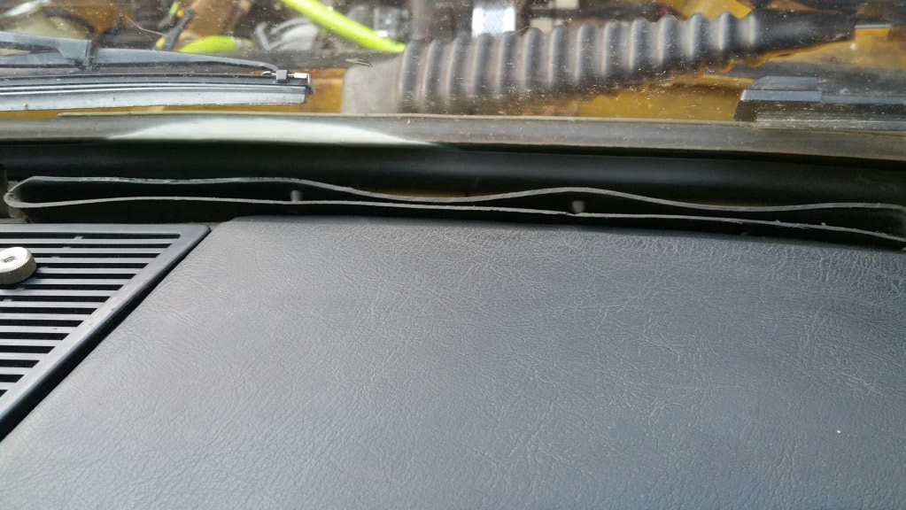

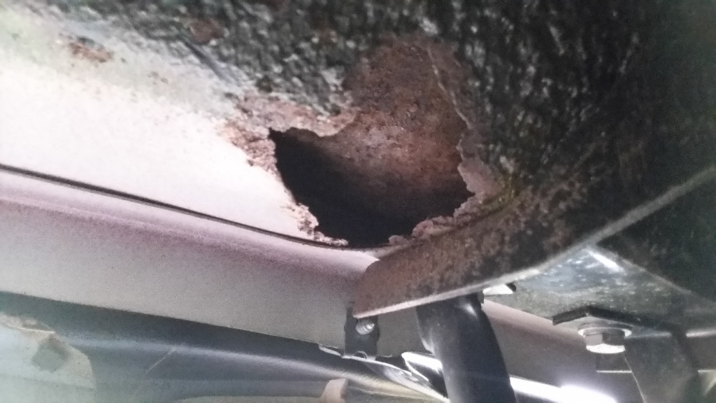

I also have this hole!
Though the screen opening is perfect and the original rubber was OK
I suspect that water has been getting into that box section via the wiper wheelbox seals for a very long time, leading to that hole. And others further along!

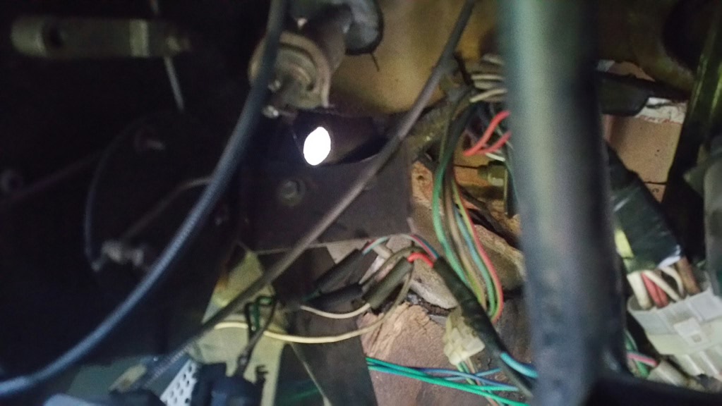

#593 Post by Mahesh »

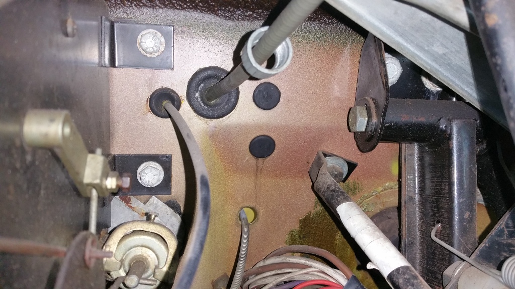

This hole has a grommet missing, only shows when the bonnet is up and light shines through.
2016-05-21 19.52.30.jpg (99.01 KiB) Viewed 1113 times
Posts: 7246
#594 Post by Carledo »
Mahesh wrote:This hole has a grommet missing, only shows when the bonnet is up and light shines through.
That one is too low down to be responsible for the rot, though it won't help with keeping carpets dry!
Missing and perished grommets in the bulkhead seems pretty common on Dolomites. I think the "I'll just wire this gadget up" brigade have a lot of rust to answer for!

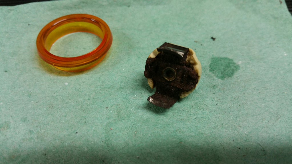

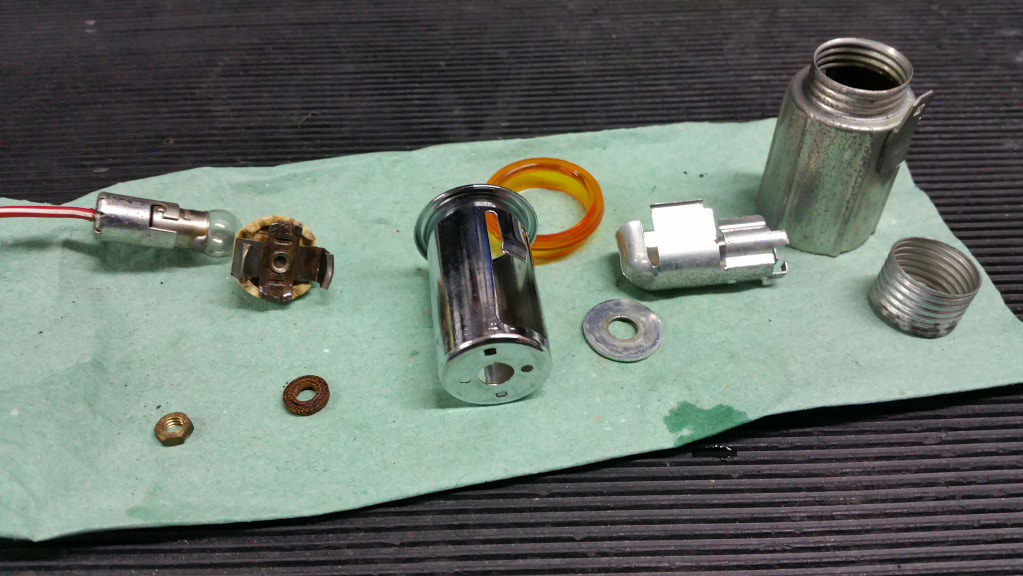

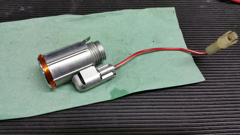

More cleaning, this time the cigarette lighter, not perfect, but I'm happy with the result,
This is the reason for cleaning
2016-05-22 19.10.46.jpg (129.24 KiB) Viewed 1062 times
It's working now
2016-05-22 19.11.12.jpg (141.26 KiB) Viewed 1062 times
2016-05-22 19.11.34.jpg (149.5 KiB) Viewed 1062 times

Have to obtain a green ring to match the dials, seems unlikely.
I may have to order an Ebay unit with a green ring and diy (bodge) it.
