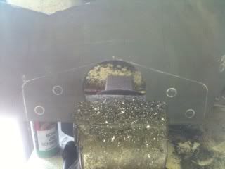

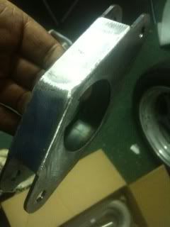

I wasn't happy with the gartrac box's as i want to run the shocks off the top of them and i want to run
my axle location off both of them
Gartrac one not wide enough
my mock up

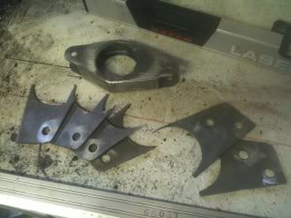

few bits cut
mine against the gartrac

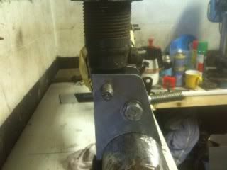

on the axle with a shock mounted
Tacked on

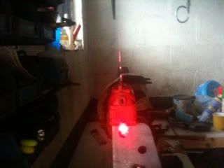

and all lined up perfect 2 deg nose down on the diff

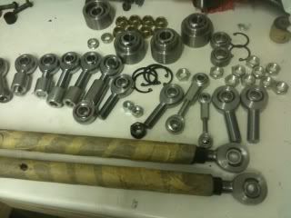

Gartrac have made my 4 link bars i had them made at 565mm eye to eye,

few bits cut
Tacked on

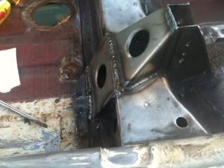

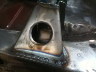

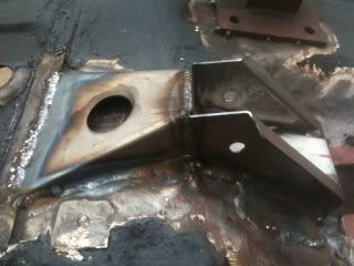

Inbetween decorating today i managed to get one of the 4 link brkts welded in and put a body brace in
The edge of the brace will tie in with the inside brace hopefully tommorow if i finish papering
And a few more bits turned up with the postie

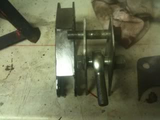

These are for my mumford link

Im going to try this link it may work it may be a pile of scrap metal
who knows
The thing with the watts link is as you lower the car the roll center goes UP,
With the mumford link its a bit different

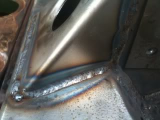

Did a bit more today

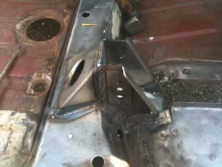

Made a couple of towers for one of the 4 link brackets
This ties in with the box under the car,
Just got to do the other side tommorow now,, more sunburn
Also started on one of the box's

Re: My new track project
That line of welding is just art.
That is indeed a very pretty weld. But then the general standard of the work as well as the thought and care going into it is extraordinarily high. I'd go so far as to say that the boundaries really are being pushed aside by this whole, amazing build.

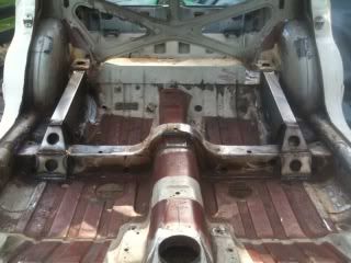

Finished the box's today,
The bit of rear seat cush area ;drivers side; im going to mod as i want to fit a diff cooler and pump
Also behind drivers seat area for the gbox cooler and pump,
But for now its onto the shock towers and im starting fab work on the mumford link,
Also the boot floor is coming out as i have a cunning plan
