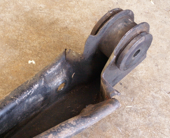

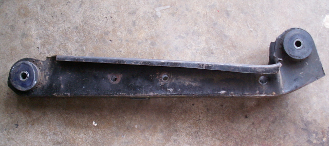

At a race meeting last Sunday I had yet another rear suspension arm failure. But this time it was not the normal failure by fatigue cracking, (I have had a few fail over the years), this time the rear arm collapsed, ie buckled with no warning.
Several years ago I had a rear suspension arm crack and fold up while racing. It was replaced and the other arm inspected with nil defects evident. The next meeting the arm on the other side also failed. My feeling have always been this is a result of fatigue, magnified by polyurethane bushes and motor racing stresses.
The latest failure has not cracked.
Rear Arm.JPG (165.87 KiB) Viewed 3335 times
Rear Arm (1).JPG (252.57 KiB) Viewed 3336 times
As you can see it has bent.
I clipped a ripple strip (curb) with the right hand side wheels which jumped the car in the air, and on touch down the left hand arm collapsed. It seems strange, as it appears that the arm just could not take the load from the compressing spring and body weight. This car is lighter than the previous (white) car and the spring and shocks are of similar setup. Other people that I know (including my brother Philip) have never had rear arms fail in 10 or 20 years of racing yet this arm that failed had only been on this car for 6 race meeting. Yet again I seem to find weaknesses in the cars that no one else seems to find.
Anyone else had a failure like this?
DavePoth

IIRC (and to be fair it was probably either you or Phil that noticed this) the problem with these is that they have to flex when the suspension gets an asymmetric load (i.e. goes over a bump on one side only) and the stiffer the bushes are, the more of the movement has to be in the metal of the arm.
I suppose any flex in the mounting points at all would be enough to stop the arms having to bend. I guess that that flexing would be affected by the way the back end of the passenger cabin is braced with a rollcage/bulkhead. Is yours done any different to other peoples' cars?

I know someone who has had several of these fail on rally cars, they usually crack and split in the same place yours has folded. His suggested solution was to either run softer bushes to stop the metal having to flex, or to weld a bar through the folded channel, effectively extending it to the end of the arm.

Nick C wrote:I know someone who has had several of these fail on rally cars, they usually crack and split in the same place yours has folded. His suggested solution was to either run softer bushes to stop the metal having to flex, or to weld a bar through the folded channel, effectively extending it to the end of the arm.
This is exactly what I am thinking.
My previous failures have been cracking, which we believe is caused from the continual flexing of the arm during cornering. The diff stays on the ground (or should) but the body rolls, therefore the arms must flex.

At this point in time my thoughts are to just plate the area around the shock attachmentment area. The object will be to strengthen arm at the weak point, but still allowing it to flex during cornering.
It might have just been a one off failure, but I am not convinced.
